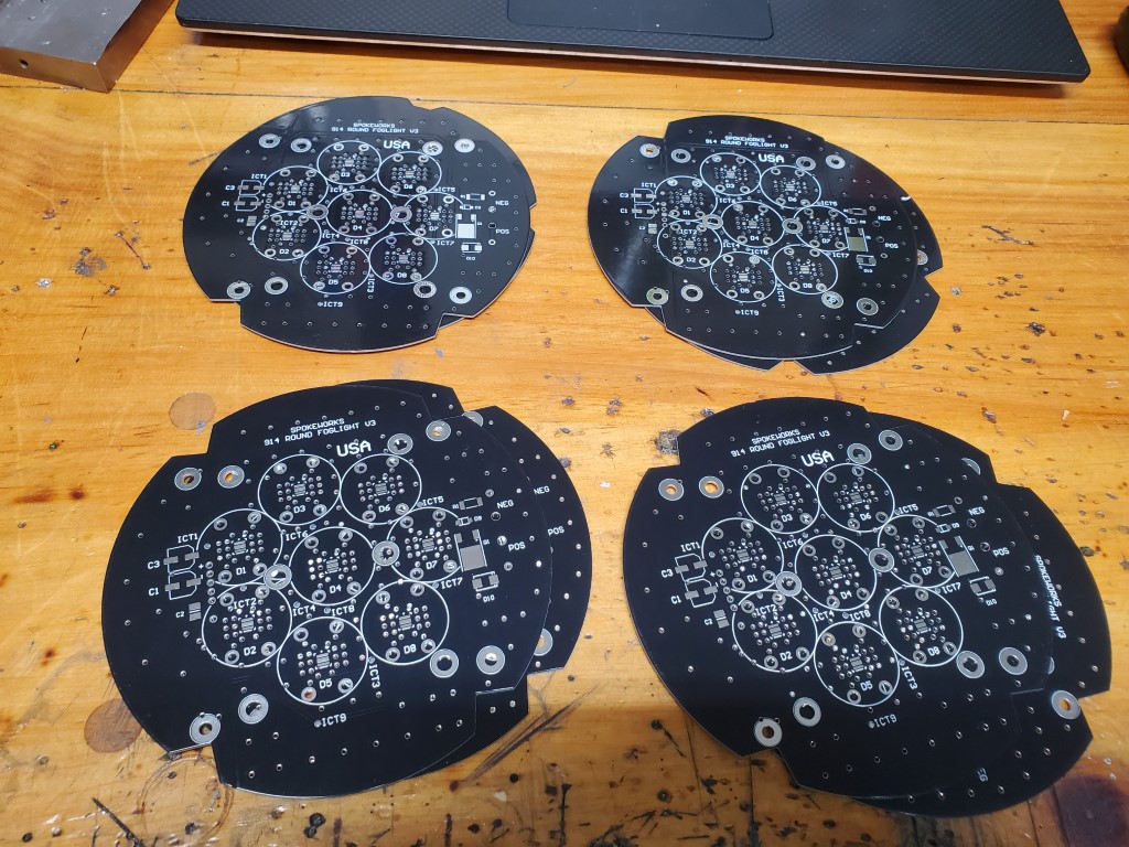

For this build, I will assemble 4 sets (8 boards). First up is to set the boards aside.

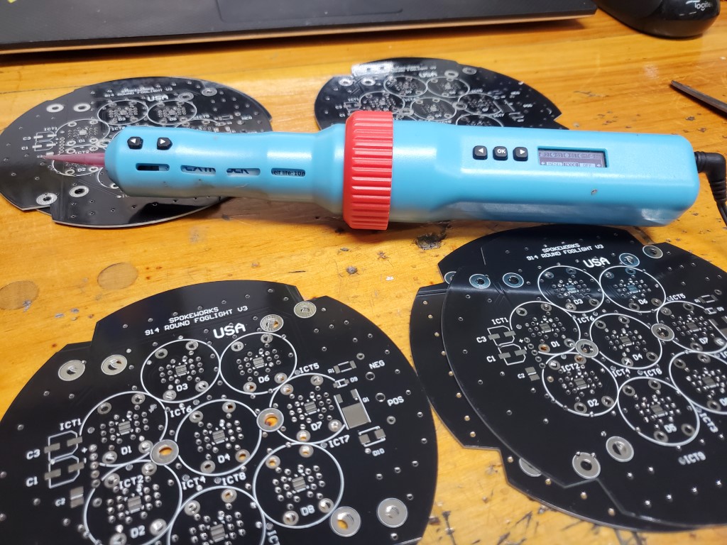

The surface mount parts are done first. The correct number of components for the eight boards are selected. This step is a pain as the exact number of parts must be pulled from the tape for each component.
The solder paste is put down with a solder paste dispenser by I-extruder. For large components a simple syringe could be used but the tiny LEDs are very sensitive to the amount of paste set down.
The dispenser allows adjustment of pressure and duration from 1 to 99. For the LEDs, the settings for both are 1. For the other components the settings are 99.
First the paste for the LEDs is put down with pressure and duration both set to 1.

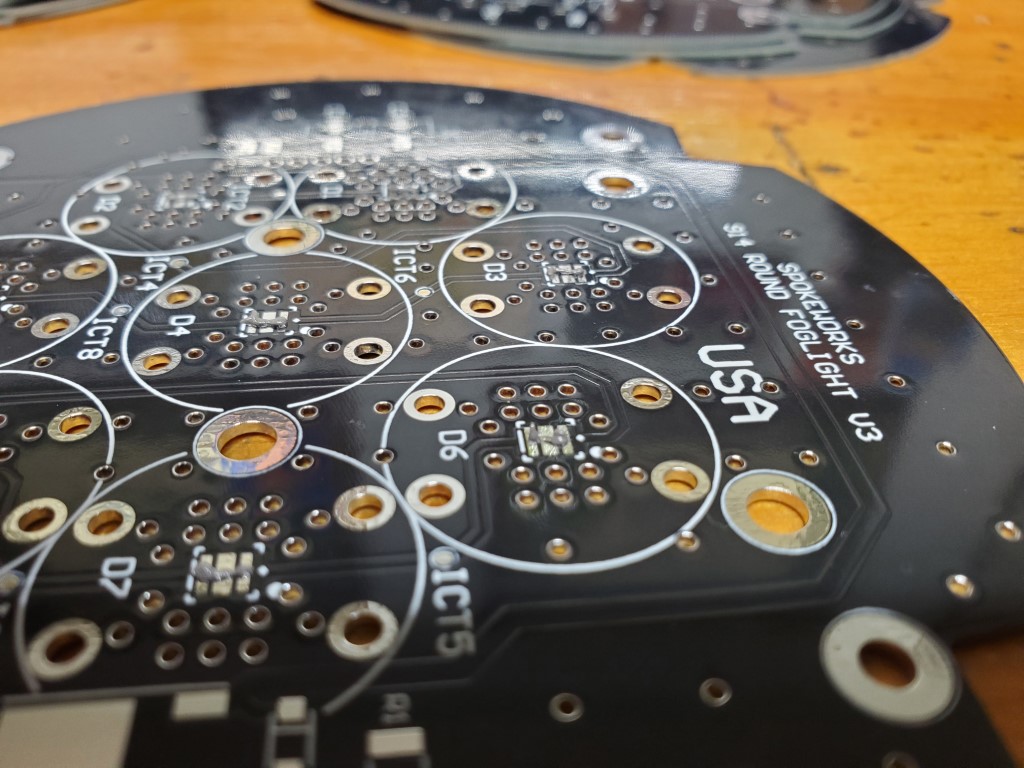

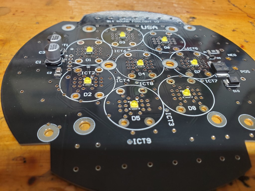

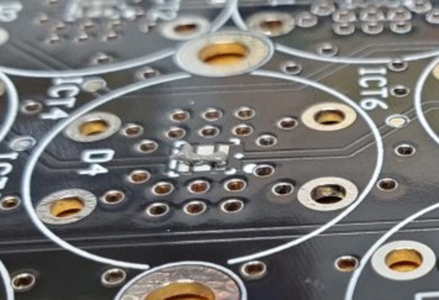

Here's a close-up of one of the LEDs. If too much paste is put down, the paste may puddle under the LED and short out the pads or cause the LED to sit crooked. The center pad is ground for heat removal. The array of vias reduce the thermal resistance of the FR4 board to the heat sink on the bottom of the board.

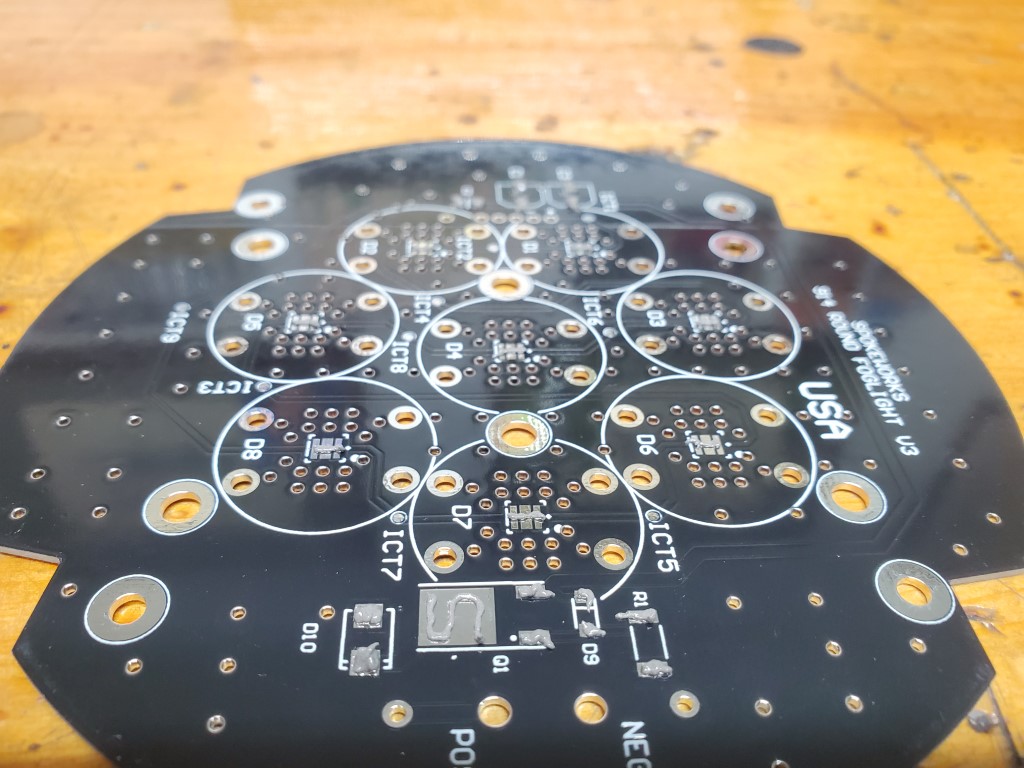

After the LED paste is down, then set the dispenser to 99 for the rest of the components. The paste is not very obvious in the picture although a zig zag of paste can be seen on the Q1 MOSFET pad at the bottom.

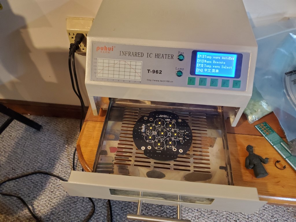

All the surface mount components are on their footprints. The paste acts a bit like weak glue and the components will not move but can be easily bumped if not careful. The board is ready for the IR oven.

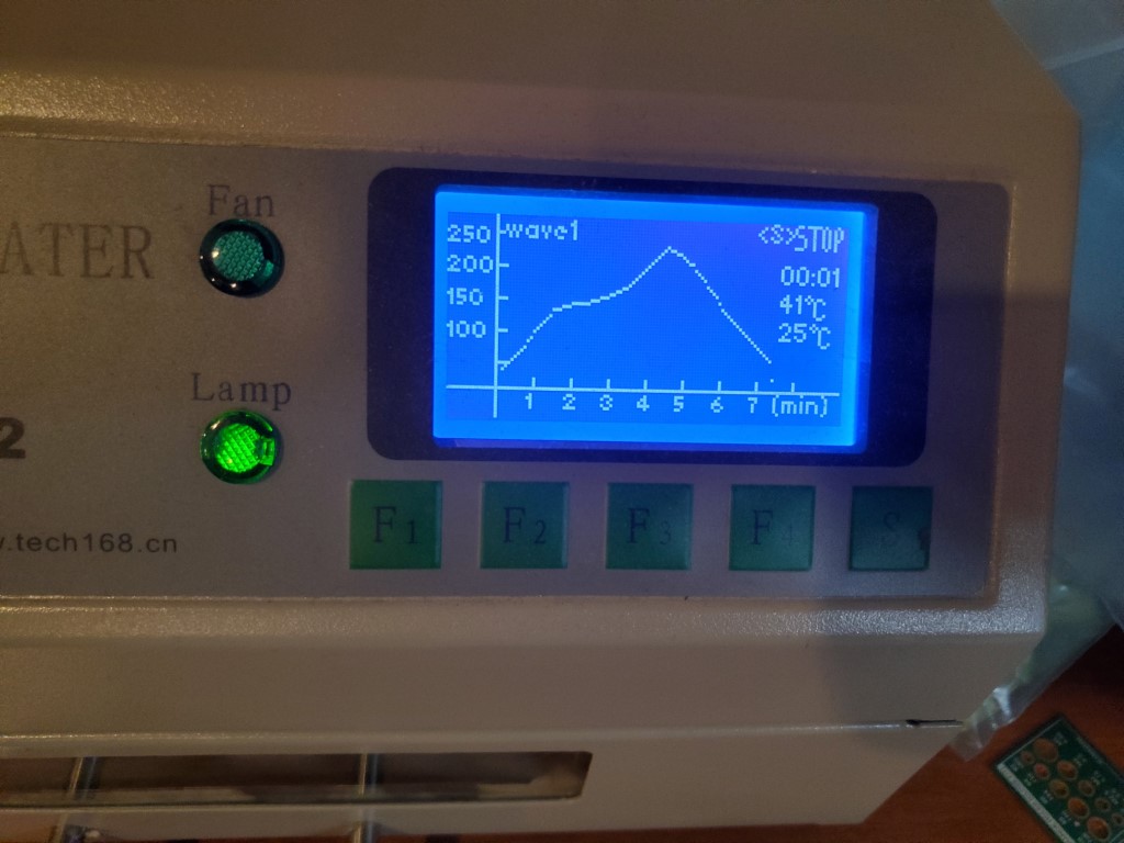

The IR oven can handle one board at a time. The total cook time is about 7.5 minutes. When one board is cooking the next board will go through the component placing.

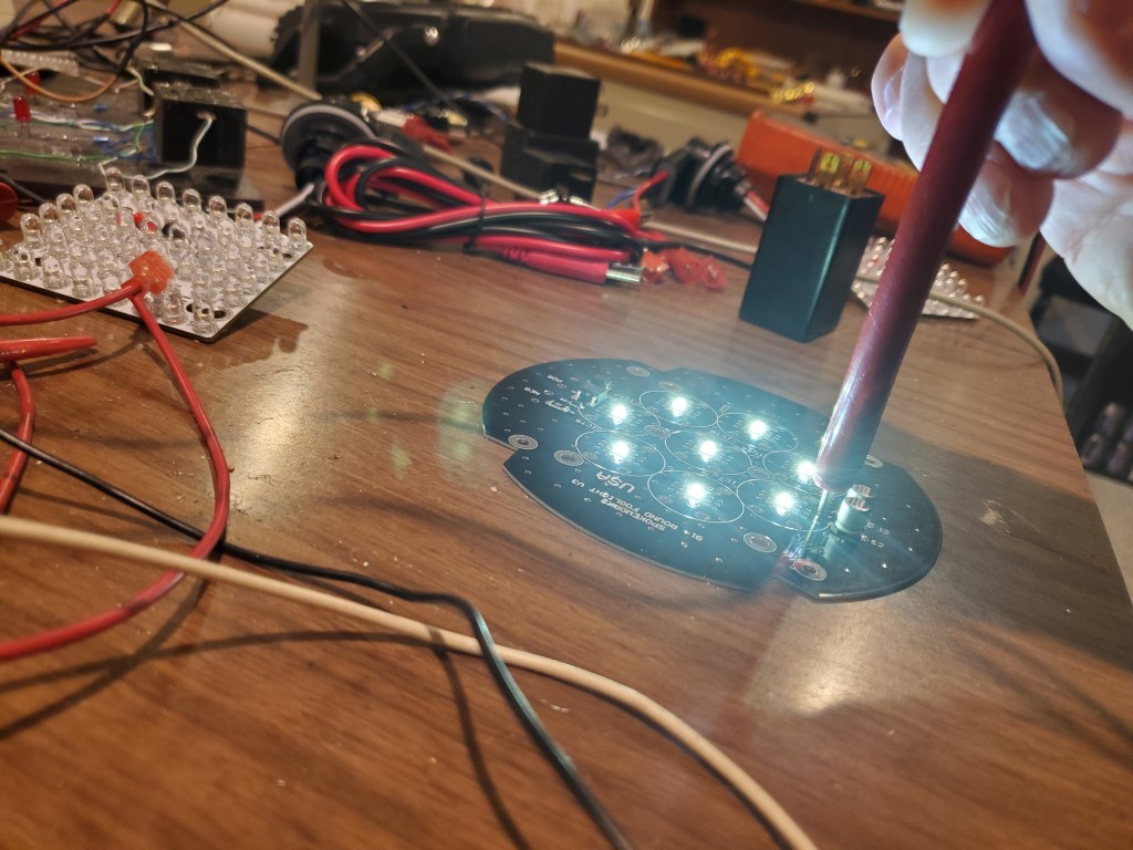

When the board is done in the oven, the LED stack is tested to make sure all LEDs are properly mounted before the dc/dc converter is soldered in. For this test a current limited DC voltage is applied. Start the voltage at zero and increase until about 200ma is flowing. This board looks good.

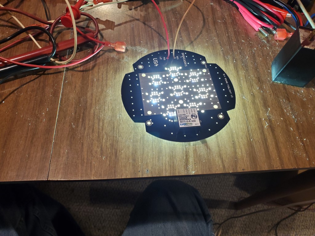

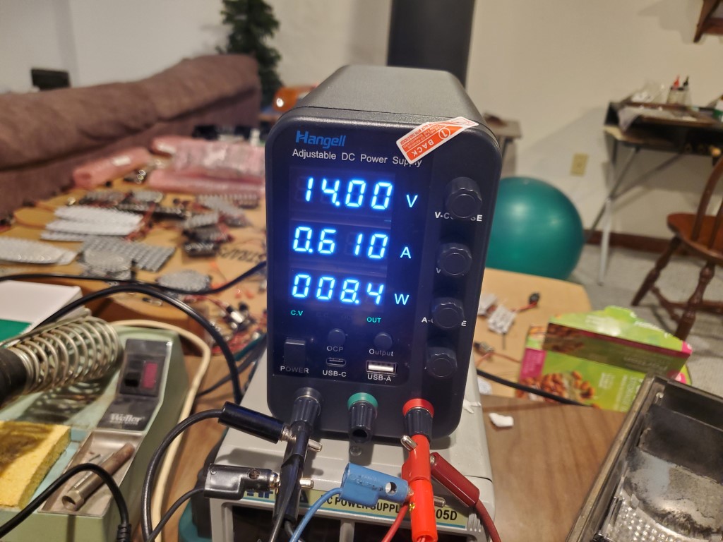

Now is the first time the entire electronics can be tested. The board is placed face down because the LEDs are so bright they are dangerous. Without the heat sink the board can only be powered for a few minutes.
The boards only take about 8.5W. This is compared to the 35W OEM bulbs. The LEDs are about 2x as bright as the bulbs.

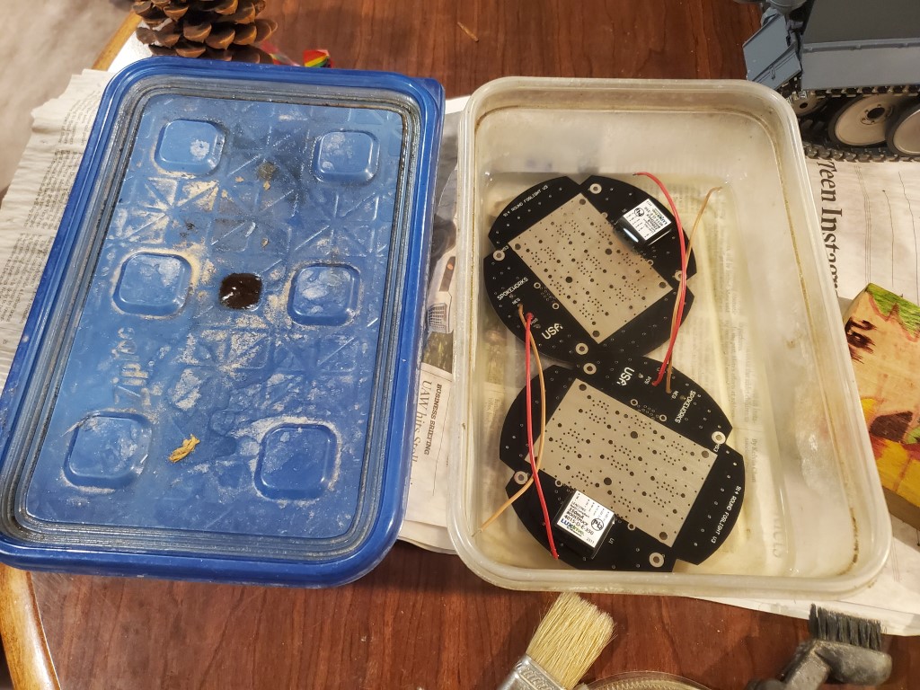

After testing the board get a double alcohol bath to clean any residue mainly from the hand soldering. Each bath takes about 15 minutes.

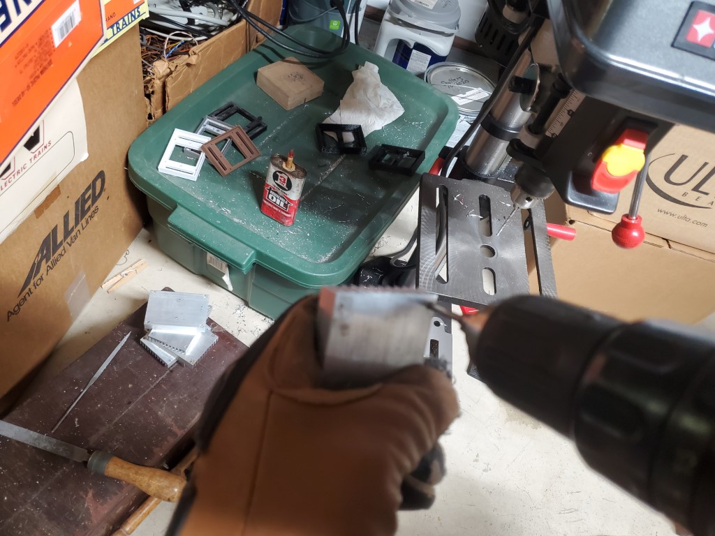

While the boards are taking a bath, time to prepare the heat sinks. Each heat sink is attached to the board with 6 screws. A 3d-printed guide allows quick drilling of the holes although each guide only lasts about 6 heat sinks before needing replaced.
Once the holes are drilled, a drop of oil is placed in each hole to lubricate the tap. A cordless drill makes quick work of the tapping process.

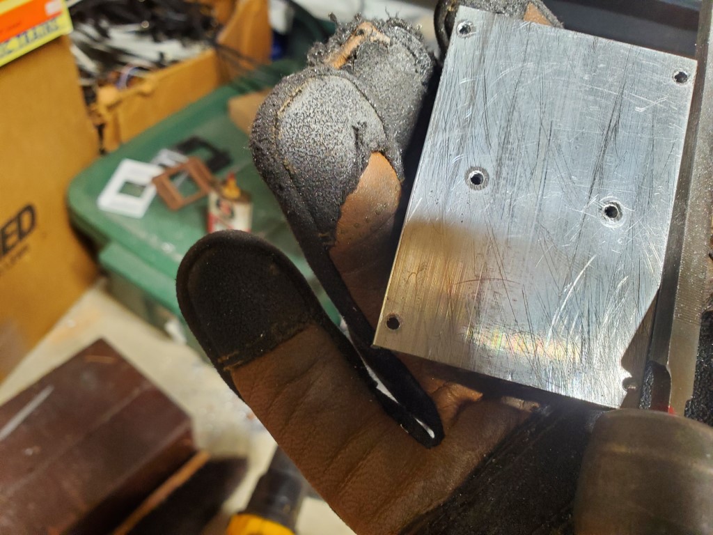

The tapping process causes the aluminum to bulge up around the hole. This needs to be filed down so the heat sink makes good contact with the board. After filing, the heat sinks are washed in a bucket with laundry detergent to remove loose particles and any lingering oil.

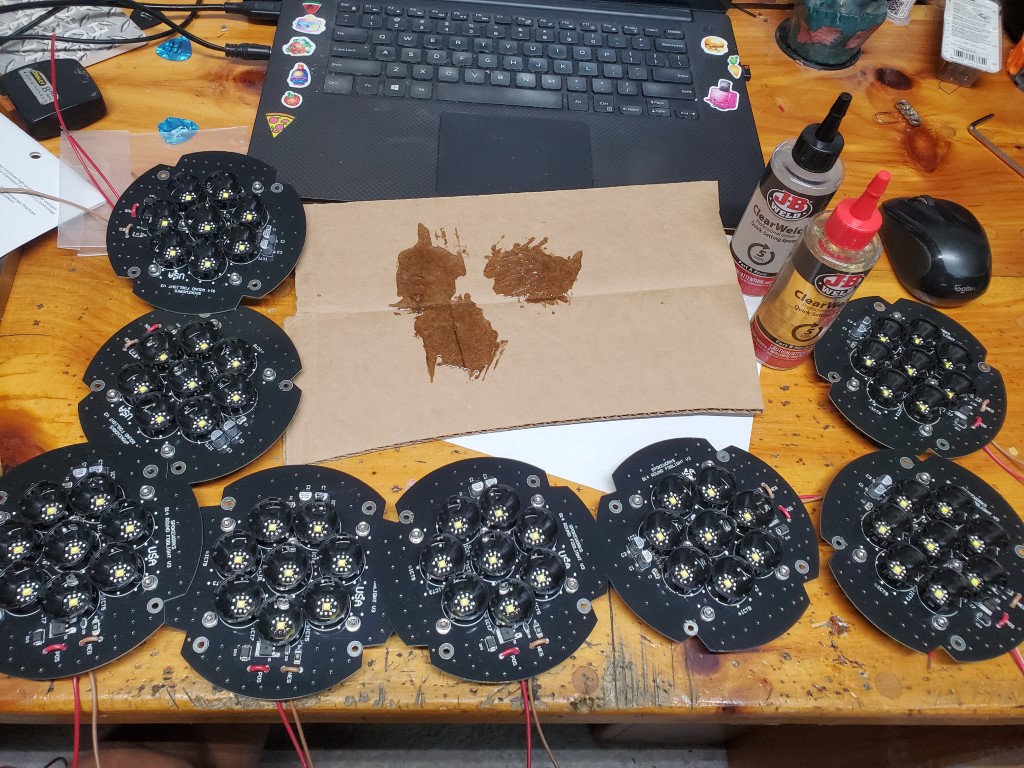

The next step is to epoxy the LED lens holders to the board.
A dab of superglue is applied to both large capacitors and the dc/dc module to dampen vibrations. This view also shows the LED lens holders.

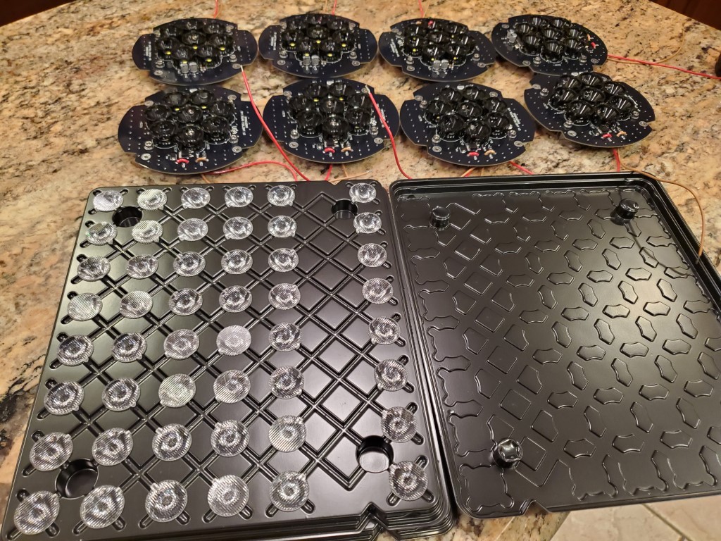

The LED lenses are now attached.

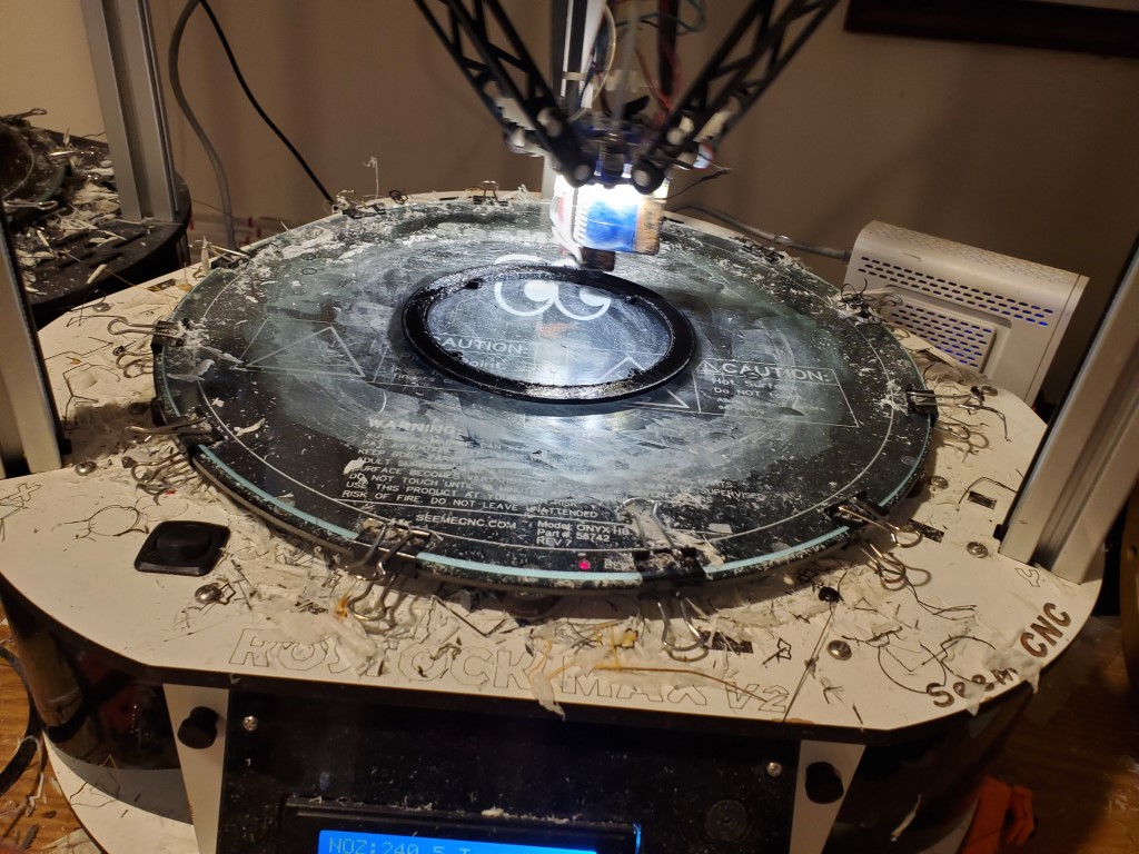

While the board assembly is in progress, printing of the foglight lens fixture is done. 3 fixtures are used for each set. One for each board and a spare. Each fixture takes about 50 minutes to print.
