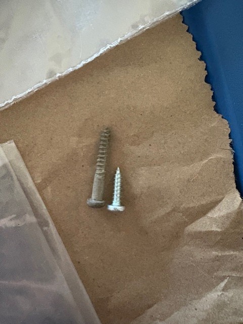

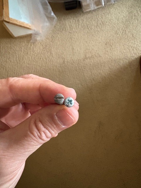

The screws for my fog light grills were the long flat head ones pictured below. PET says that the correct screws are 3.5 x 13, which are the short ones pictured below. All 8 on my car were like the long one. Based on my experience with this car, if all 8 screws are the same then they probably were the original screws (POs were clearly too frugal to change all 8 just to be consistent). So, for those that know what was original, are the long ones correct?

The long ones are not correct. I would trust PET

Long ones are wood screws, not correct originals. My 73 has Phillips pan head stainless about the same length as your other one, and I replaced the original rusty body clips with plastic expanding anchor "plugs" that fit perfectly in the original body holes, and won't rust.

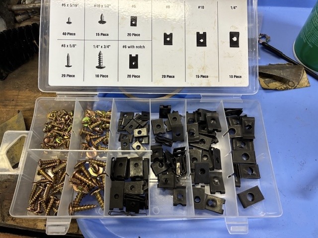

Harbor freight has a box with workable hardware.

As far as the screws in the OP's post, I just replaced mine a few days ago. The size looked correct, I'm not sure if the originals were stainless or not, but the ones in mine were badly oxidized silver zinc. I replaced them with stainless. They were 3.5mm x 16 sheet metal screws (the sheet metal nuts in the bumper were OK). In the US I think that is the equivalent of a #6 x 5/8" sheet metal screw.
