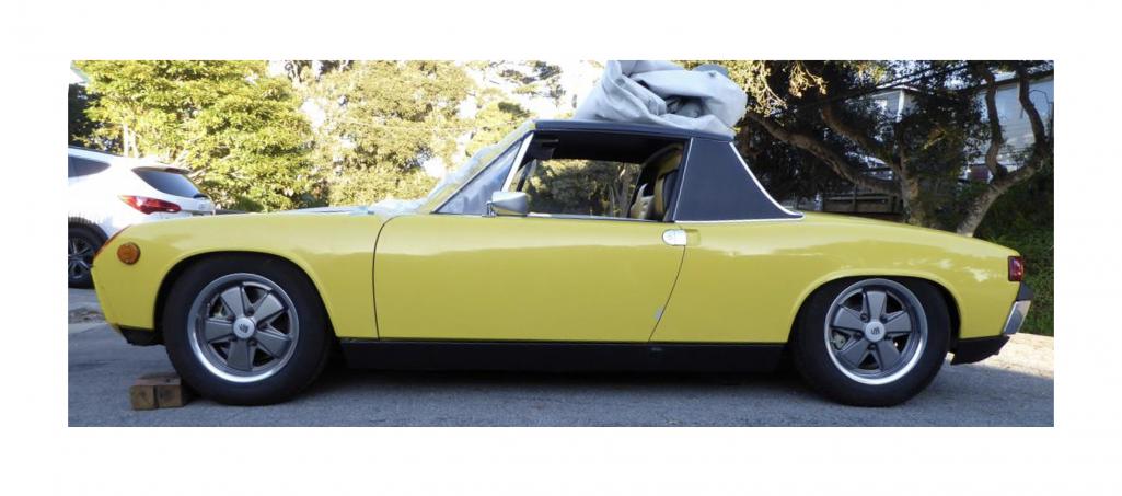

> Fresh air while I cleaned the garage.
914043
post Dec 10 2025, 12:38 AM
Posts: 100
Joined: 2-April 19
From: California
Member No.: 23,007
What are your thoughts on stance, I like lowered compared to stock?Attached Image
Dave_Darling
post Dec 10 2025, 02:36 AM
914 Idiot
Posts: 15,301
Joined: 9-January 03
Member No.: 121
Nice! It might be a bit too low, but the angle of the driveway makes it a bit difficult to tell.

VaccaRabite
post Dec 10 2025, 06:21 AM
En Garde!
Posts: 13,819
Joined: 15-December 03
From: Dallastown, PA
Member No.: 1,435
Looks like a submarine emerging.
You will need bumpstops from the front and crank it down till level. And then you will need an alignment.

post Dec 10 2025, 07:53 AM
Michael
Posts: 10,518
From: Auburn, CA
Member No.: 9,712
They look good low, but the rear is very low and I think needs to come up at least 1", maybe more. I have mine set so it sits higher in the rear than the front by about 1/2". (IMG:style_emoticons/default/beerchug.gif)

bkrantz
post Dec 10 2025, 08:46 PM
Posts: 8,550
Joined: 3-August 19
From: SW Colorado
Member No.: 23,343
Here's my quick edit to get the wheels close to horizontal. The car now looks very level. That's fine, but I prefer just a bit of forward rake.

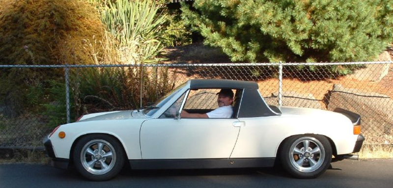

Member No.: 8,476
New springs needed?
post Dec 11 2025, 11:34 AM
Posts: 11,063
15x7s, 205/55, 120lbs adjustable perches..
flxzcat
post Dec 11 2025, 01:24 PM
Posts: 96
Joined: 13-June 11
From: Lake Forest, So. Cal.
Member No.: 13,188
lower the front 1" and raise the back 1"

rgalla9146
post Dec 11 2025, 06:49 PM
Posts: 4,894
Joined: 23-November 05
From: Paramus NJ
Member No.: 5,176
Take a picture on level ground.
Pretty widely agreed that nose down and low is best.
Nose up is worst.
Just sayin'

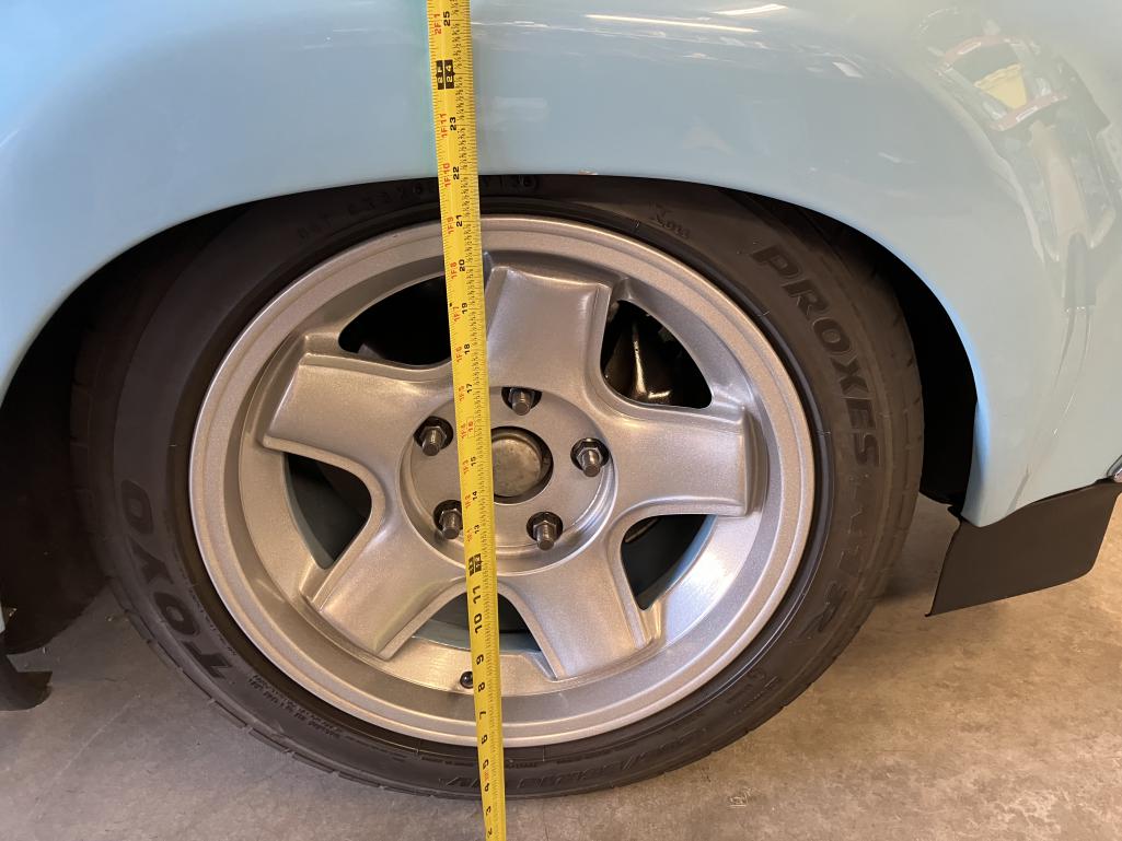

PanelBilly
post Dec 11 2025, 09:23 PM
Posts: 5,936
Joined: 23-July 06
From: Kent, Wa
Member No.: 6,488
This is where I set my back wheels.
