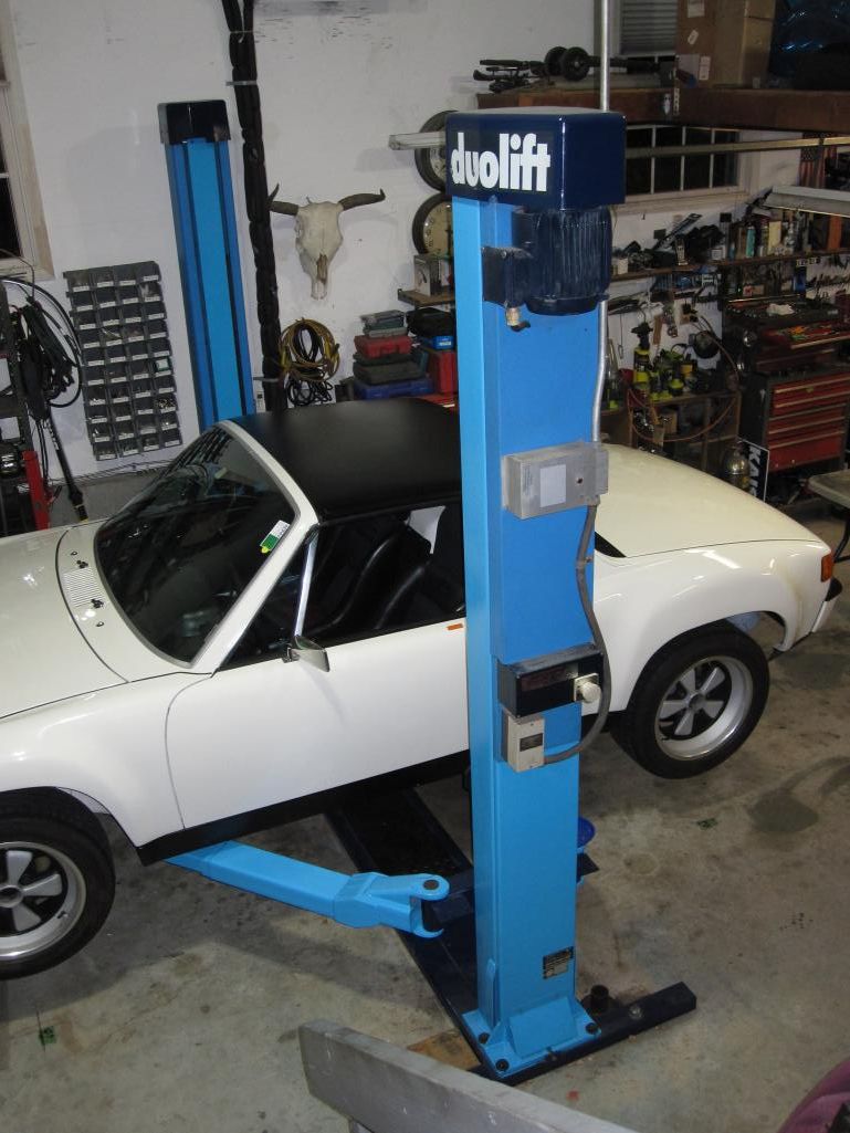

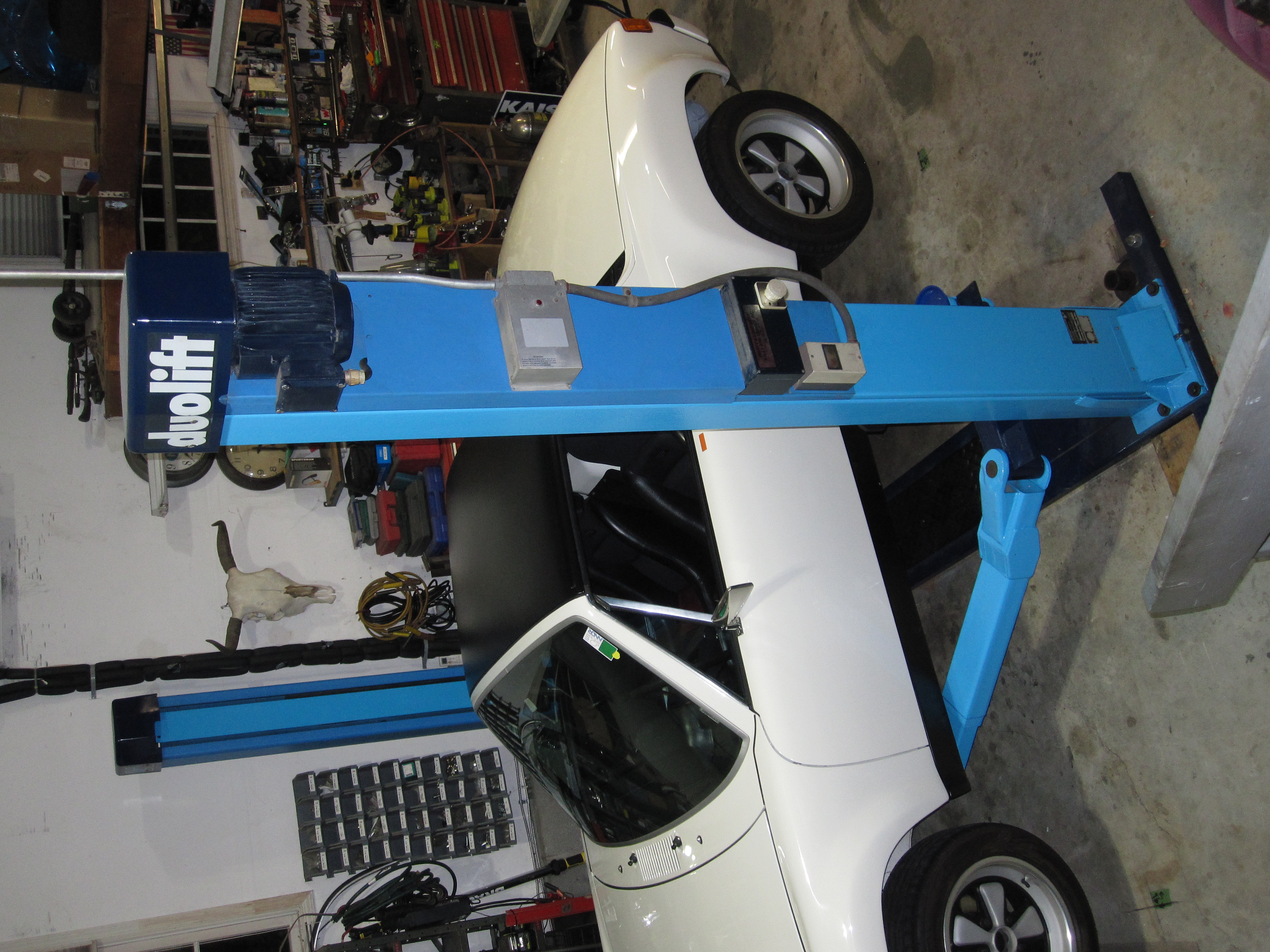

After hearing my 45 year old Hoffman service lift complain while raising my 2100 lb.

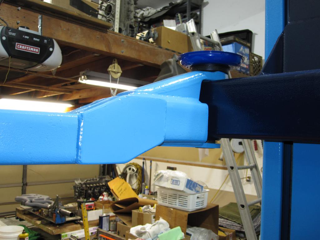

car, I knew it was time for action. It was purchased new by Jaguar Cars North America while they were headquartered in Leonia, New Jersey. I bought it from them ~1993 Luckily I was able to get OE service and repair parts from Germany ... pre-tariff thank goodness. This included V belts, a chain, chain guides and lift nuts and safety parts. I was even able to get a service and repair manual ( PDF ) from the current Hoffman organisation in the US. While I was at it I modified the lift arms to more easily swing them under my lowered car. I cut and lowered the arms 1 1/2" and welded with added gussets. After plenty of de-greasing, cleaning, welding, re-assembly, adjusting and painting it's back at work. Attached thumbnail(s) |

rgalla9146 I've tried rotating the pic a couple ways at t... Dec 4 2025, 05:41 PM
bkrantz
I've tried rotating the pic a couple ways at ... Dec 4 2025, 07:54 PM
I've tried rotating the pic a couple ways at ... Dec 5 2025, 08:48 AM
