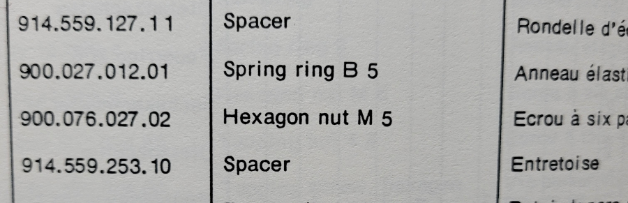

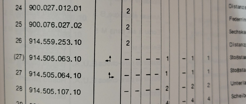

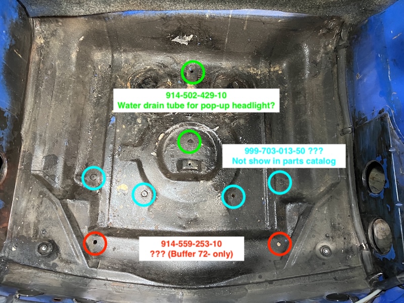

Working on 1970 914-6. Trying to verify what the correct plugs are for the various holes found in the frunk / underside.
I think I found most of my answers in What do you have under your front trunk? and 1974 914 Front Trunk Originality Question, Grommets/Drain Tube(s) threads.
* Green rear of frunk (top of photo) - drain tubes that are listed in parts catalog as being for pop-up headlights. (914-502-429-10)
* Blue in middle - Not shown in parts catalog. Use same plug as found on 914-6 hot air socket? (999-703-013-50)
The exception I see is the 2 frontmost holes (bottom of photo). The listing I see in PDF parts catalog indicates that 914-559-253-10 buffer is for 72-. What goes there, if anything, for a 1970 car?
Thank you.
post Dec 3 2025, 08:34 PM
Posts: 11,260
rubber bumper for front valance.
