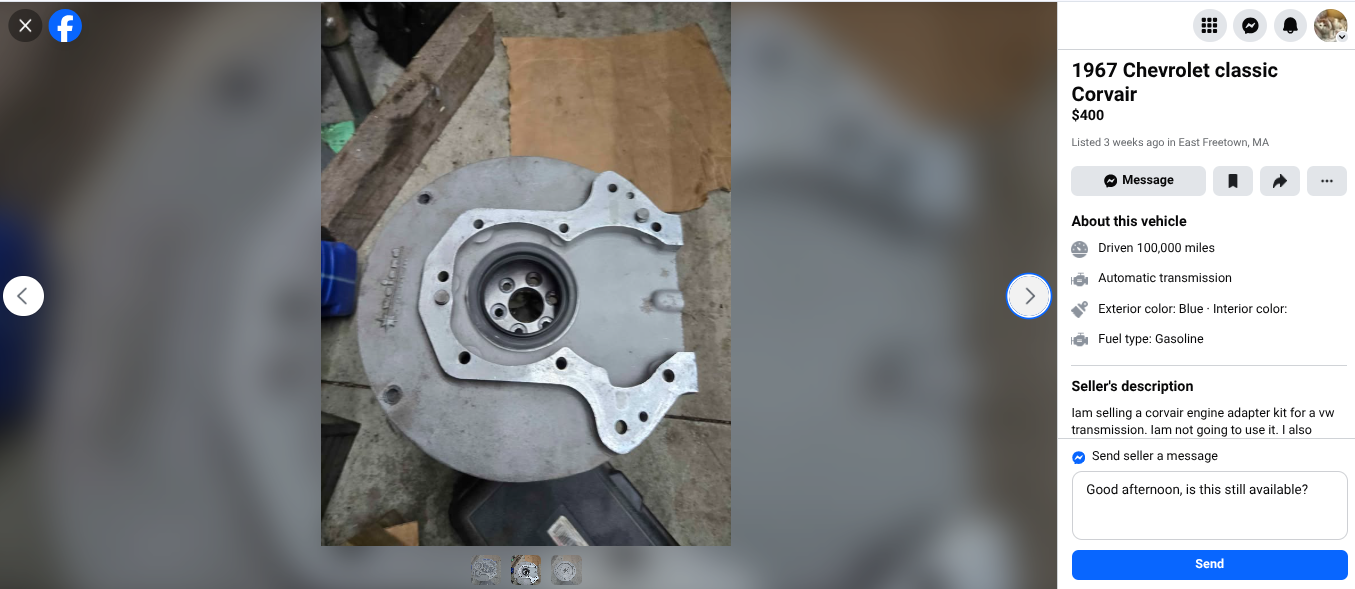

Reverse rotation issue is simple. Reverse rotation cams have been around for decades
The mount to a VW based transmission is simple also.
Here is an adapter for sale on Marketplace for cheap.
Clarks Corvair Parts is a great resource for info..
