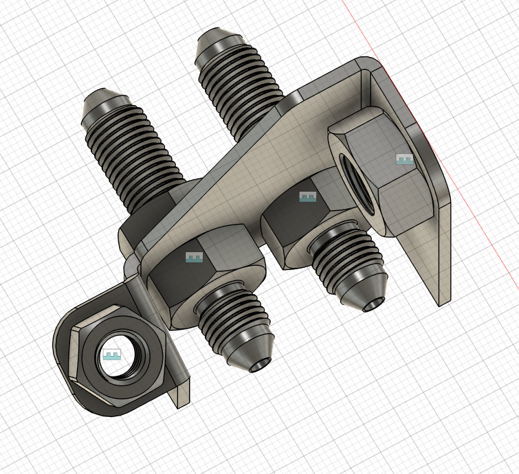

Thanks to @tygaboy for his mentions of SendCutSend, getting small sheet metal parts made is just too easy.
Start with modeling the part, in this case, the HRB bleeder and line bracket:

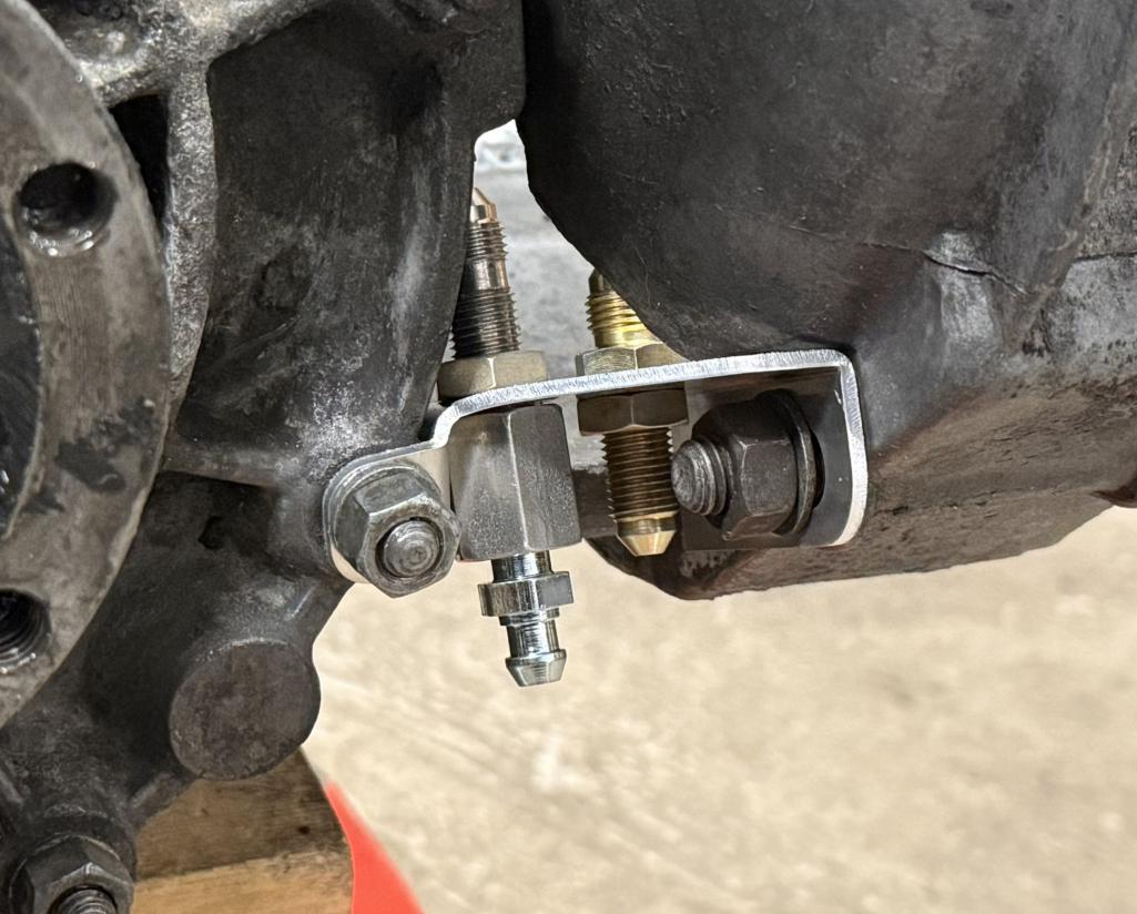

Then order, receive and install said bracket:
Hydraulic lines are next...
