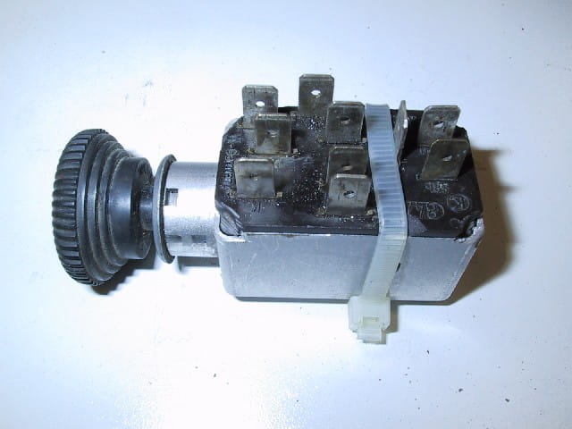

my previous (no longer my current...) mechanic just did some electrical work on my wiring and promptly shorted out my working headlight switch so I am in need of an OEM replacement or information on where I can get an identical working, new replacement. My search online for a new OEM or even a RePop has resulted no finds. I am still a newbit at the 914 thing so it could be lack of knowledge as well. I tried the common West Coast suppliers and didn't see anything and an EBay search leads me to believe it's not an available part new any longer. I have a '73 original 2.0l car converted to 3.0l 6 from '79 911 SC. Any help appreciated.

There’s an early and a late headlight switch. I think ‘73 was a transition year. So you could have either switch.
Remove your switch and take a pic of the side with the electrical connections and the part number if possible. The number/pattern of electrical posts will indicate if you have early or late.
post Nov 23 2025, 07:41 PM
Posts: 9,951
The two versions can be identified by the number of spades:
Early are 10, Late 11

I believe all 73 cars had the early switch.
Drop the fuse panel and.
Pull the switch out to confirm. Leave all wires attached.
I have some early switches. Im in Riverside.
PM me and I provide my cell so we can talk.

Check out this light switch repair article:
https://www.pelicanparts.com/techarticles/9...lamp_switch.htm
