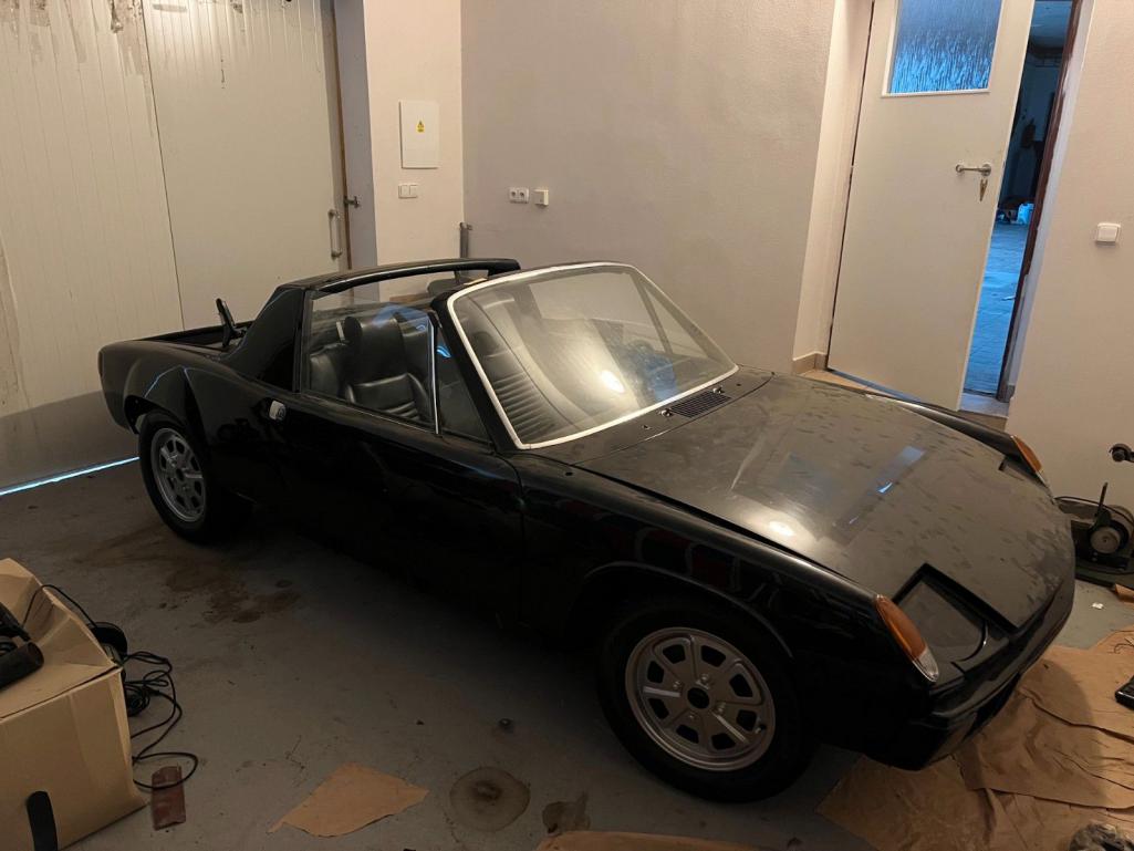

Hello all,
I was on historic motorcycles for years but was waiting for the right moment to switch to classic car instead. I was also searching classifieds for several years choosing the right classic car to buy. The main contenders were BMW 2002 and Porsche 914.
Unfinished project Porsche 914 appeared for sale not far away from my place some half a year ago. So I went there to have a look. Due to the personality of the seller and obvious intention to sell cheaply we agreed on buying price. Project is 75% finished and there are plenty of spare parts (He had a donor car). But some parts are missing too.
1. The main issue here is absolutely no history! The car was restored by professional car mechanic who died and all his pictures, notes, paperwork, receipts, documents are lost, stolen and missing.
2. My other problem is that I´m Central Europe based and my German is poor. So my only source of information is this forum in US. There doesn´t seem to be such enthusiastic fan base of 914s in Germany and it´s not much economical to order work and parts in Northern America for me.
3. I´m brave enough to do any welding or assembly jobs on my car but I don´t have much experience and I´m not very handy.
Despite all this I would be REALLY thankful if I get any support from well experienced guys here because I have all the commitment to bring another Porsche 914 back to the road.
This build will be for modified Porsche 914 – I would like to upgrade certain parts but rules for historic cars are stupidly strict in my country
I will really appreciate your help with the following:
1. There is 2.0 refurbished T2 bus engine in the car. That will be removed and sold as it is. From all the spare parts I have I would like to build 2056cc engine using my 1.7 crankcase and 1.8 heads (will need to source 2.0 crankshaft and rods, the right camshaft, 40 Webbers, 96 cylinders and pistons).
2. Car electrics – One is in the car but seems to be a bit messy. I have a complete spare one but it´s far from being perfect. I would like to remove FI wiring and add central locking, electric windows, DLR, intermittent wipers, electric windscreen washer
3. Car body is sound and recently resprayed. But I don´t like the colour and the rear wheel arches. Therefore it will be converted to GT flares, will be lowered and go on 16” 205/225 wheels. I would like to weld some reinforcement into the tub.
4. Car interior will need to be done from scratch – All the door window and targa roof trim and seals is missing. I want more like Sheel sport seats. Dashboard to be assembled. Foot pedals to be assembled and connected. New carpets installed.
5. I search for reliable and cheap European parts suppliers
So this is my mission and this is my carAttached ImageAttached ImageAttached Image Attached Image

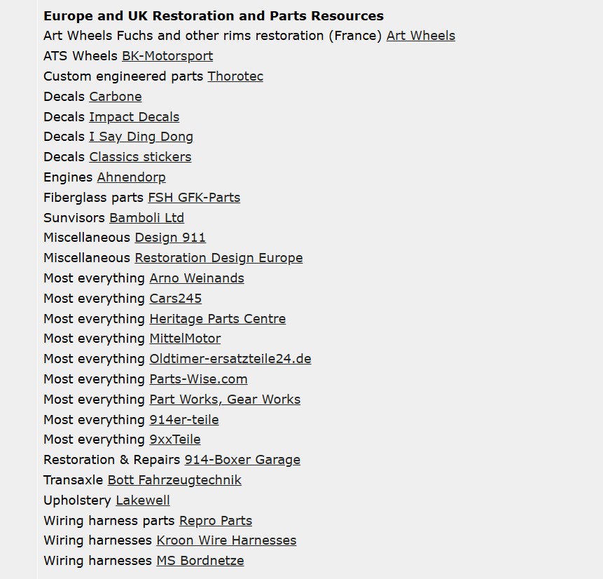

QUOTE(Pyetookh @ Nov 21 2025, 02:19 PM) *
I can't help you with the non-stock stuff much but...
Here you can find a list of 914 suppliers, there is a European section...
I have ordered from Partworks.de, 9xxTeile.com in Germany, RosePassion in France (they ship pretty much everywhere, they are not listed in the European section, but further up) and some others. You may also find some stuff will still be best ordered in the US, despite the expensive shipping involved.
Good luck!

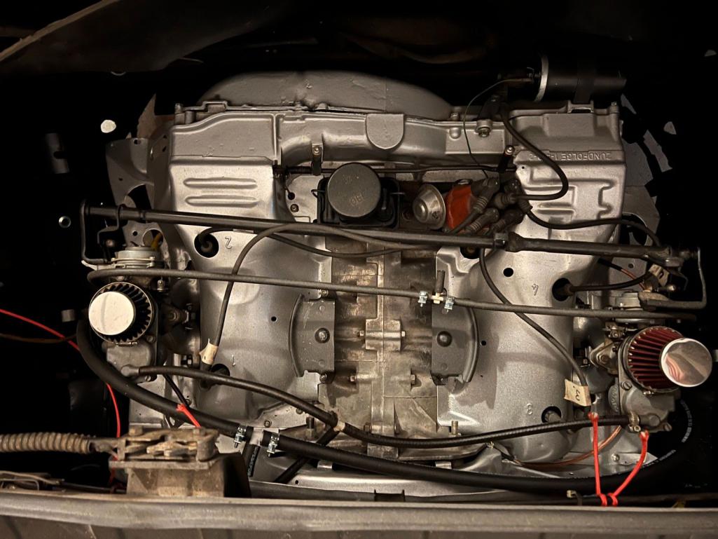

Gentlemen, can someone advise me how to get around 100 HP or a bit more from Type 4 engine without using crazy expensive 71mm crankshaft, please? (IMG:style_emoticons/default/WTF.gif)
71mm Porsche crankshaft, rods and 2.0heads are crazy expensive in Europe.
I "inherrited" 1.7L and 1.8L crankcases, 66mm crankshaft with related rods, 1.7L and 1.8L heads, brand new Mahle (Brazil) 94mm barrels and dished pistons for T2 engine (78mm).
Can get my hands on 78mm crank and rods, ready to buy Webbers and big bore barrels.
Would the following work together, please?
1. 66mm crankshaft + 1.8L heads + 96mm barrels + IDF 40 Webbers
2. 78mm crankshaft + 1.8L heads + 94mm barrels (dished pistons) + IDF 40 (or 44) Webbers
3. Other options?
My goal is at least 100Hp, reasonable fuel consumption and reliability, obviously cost. Like to drive fast (IMG:style_emoticons/default/driving.gif) without paying too much.
Any advice is very welcome. Thank you (IMG:style_emoticons/default/head_hurts_kr.gif)

Your engine is serious piece of kit. Must be fun to drive such car. (IMG:style_emoticons/default/driving.gif)
I spent some time reading a few forums last night to collect info on 1.8 big bore builds. Got only very vague information that it can be done but you need to take into account some extra heat, find the right cam, count compression ratio and shim cylinders etc. Someone recommended not to exceed 8.5:1 CR. And that was it. No more details.
I thinking to go for these:
original 66mm crank and rods
1.8L heads
1.7L crankcase (code W)
barrels https://www.design911.com/p/cylinder-kit--b...ource=doofinder
pistons https://www.design911.com/p/piston-set--fla...ource=doofinder
IDF 40 Webbers
Don´t know what cam to choose
What do you think, folks? Can such setup provide any good powerplant?

You might want to look into having some work done to those heads. Lots of horse power can be had or lost with the head work. Once you know what you are going to do, for example open the exhaust port clean up the intake and larger valves. This will affect your flow numbers. This link will take you to a place that can hear what you are putting together and sell you the correct cam and lifters. You can get your valve springs and pretty much anything you’ll need for this build at this place.
https://lnengineering.com/type-4-store.html?limit=all
