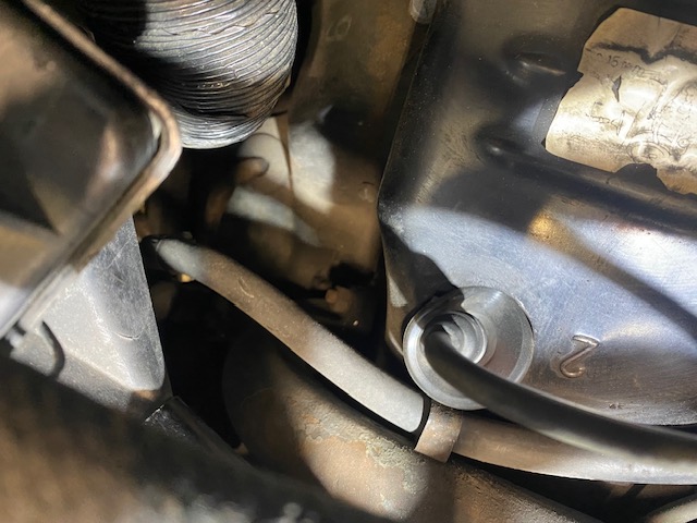

Hi… I have a 74 2.0 D jet and was wondering about the routing between#2 and#4 positions. Is this hose supported some how?A picture would be appreciated. T.I.A. Dennis

I don't have my '74 2.0 here at my house this morning, so I don't know how much help this is for you, but on my '75 1.8 that hose has a metal tab holding it in place at the #2 cylinder (picture attached). It also attaches to the cold start valve mid run, so that is different than the 2.0. I'll post a picture of the 2.0 if I get over to it today. I'll be over at my second garage tomorrow for sure.
Here's a link to the 2.0 fuel hose diagram on Jeff's website:
https://bowlsby.net/914/Classic/zTN_FI_Hose....0L_1973-74.jpg
You may find the diagram of the fuel hose layout for the 1.8 helpful as well:
https://bowlsby.net/914/Classic/zTN_FI_Hose....8L_1974-75.jpg
