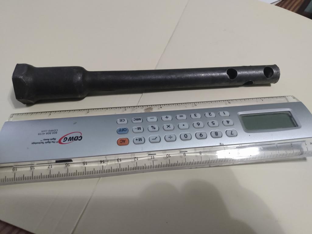

This plug socket came with my -6 when I got it 48 yrs ago. Plenty long enough and flexible rubber 'cone' inside. Haven't done plugs in years, but if I recall, it worked fine for both insert and remove. Attached Image

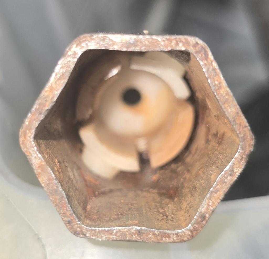

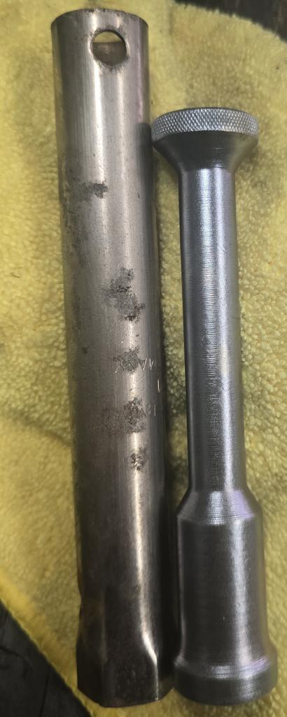

This is a BMW spark plug tool next to a 911 sparl plug tool.
It should work. It uses a plastic clip inside
@sixaddict

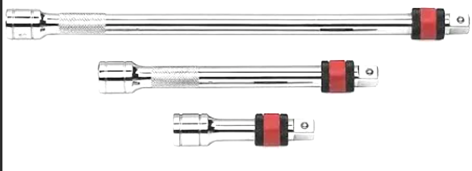

Locking extensions solve the issue of the socket getting stuck on the spark plug after installing the plug. Useful for many other situations as well.
Example:
https://www.amazon.com/Neiko-00295A-Extensi...TFAA/ref=sr_1_6

I second locking extensions but with a pin detent instead of the little ball as I have had spark plug sockets pop off inside a spark plug tube with the ball type locking extensions.
