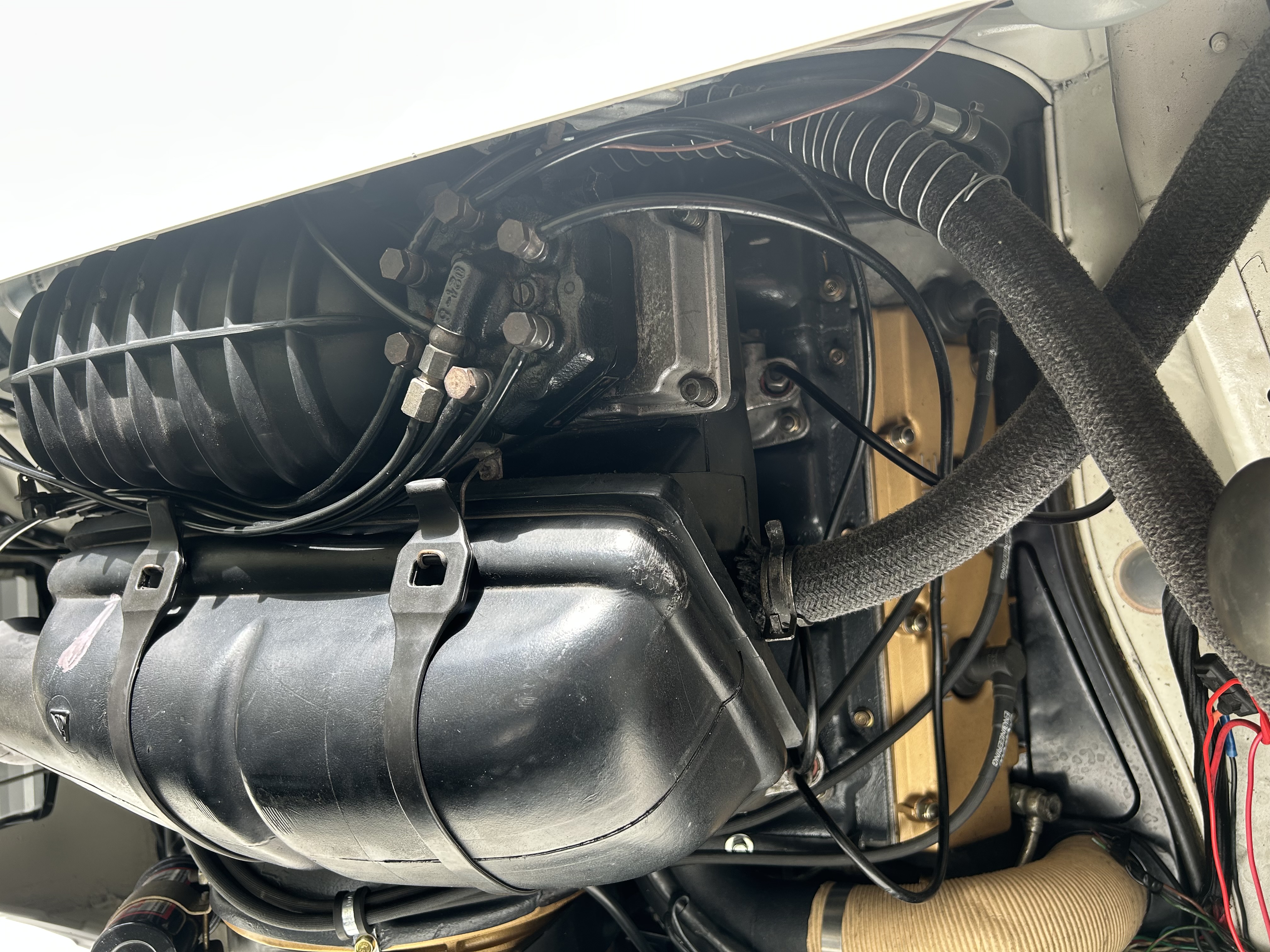

I have almost your same engine in my 914 (1974 2.7 CIS). To me it looks like you have the correct fuel distributor to just barely fit without cutting the trunk firewall (see picture above). Hopefully you already know that you will need to cut off the trunk latch part in the engine compartment (not just the latch that unbolts but the whole thing), engine won’t fit other wise. Please feel free to reach out with any questions, I can send you the wiring diagram I made to make the engine plug and play with 914 wiring harness and 2.7 engine harness

Attached Image more pics if they help

Also I am running the mad dog mount with my 2.7 CIS engine. Set the mount as low as you can. The one issue I do see with yours is that grey elbow coming off the black rubber “peanut” boot, mine doesn’t have that and it looks like it might be in the way. Might have to see if you can eliminate that somehow and go with earlier style boot

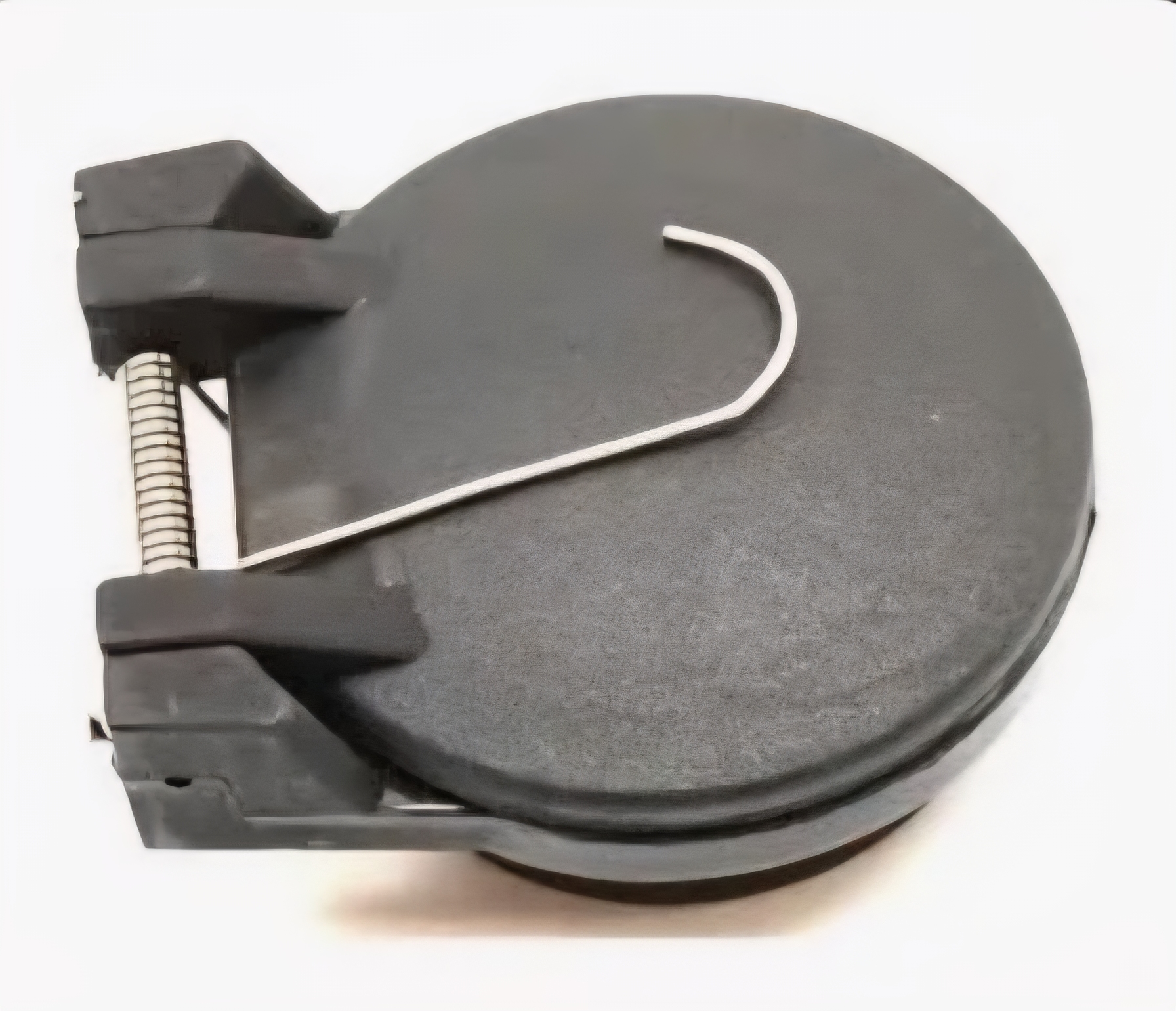

If your CIS airbox is not equipped with this simple 'Backfire air valve, I highly suggest as the black plastic airbox goes bye bye on a bad cold start backfire. All 6 neoprene 'O-rings at the base of the CIS injectors should be refreshed with new ones too. Good time to inspect the condition of the fuel lines:
engine and chassis.
(IMG:style_emoticons/default/marty914.jpg)

Left side. Trunk and engine cover torsion springs are not affected. You can see on my black intake boot where there are grooves where the engine lid rubs a little. To me not a huge deal but you could file it down a little or notch the engine lid if you want Attached Image
