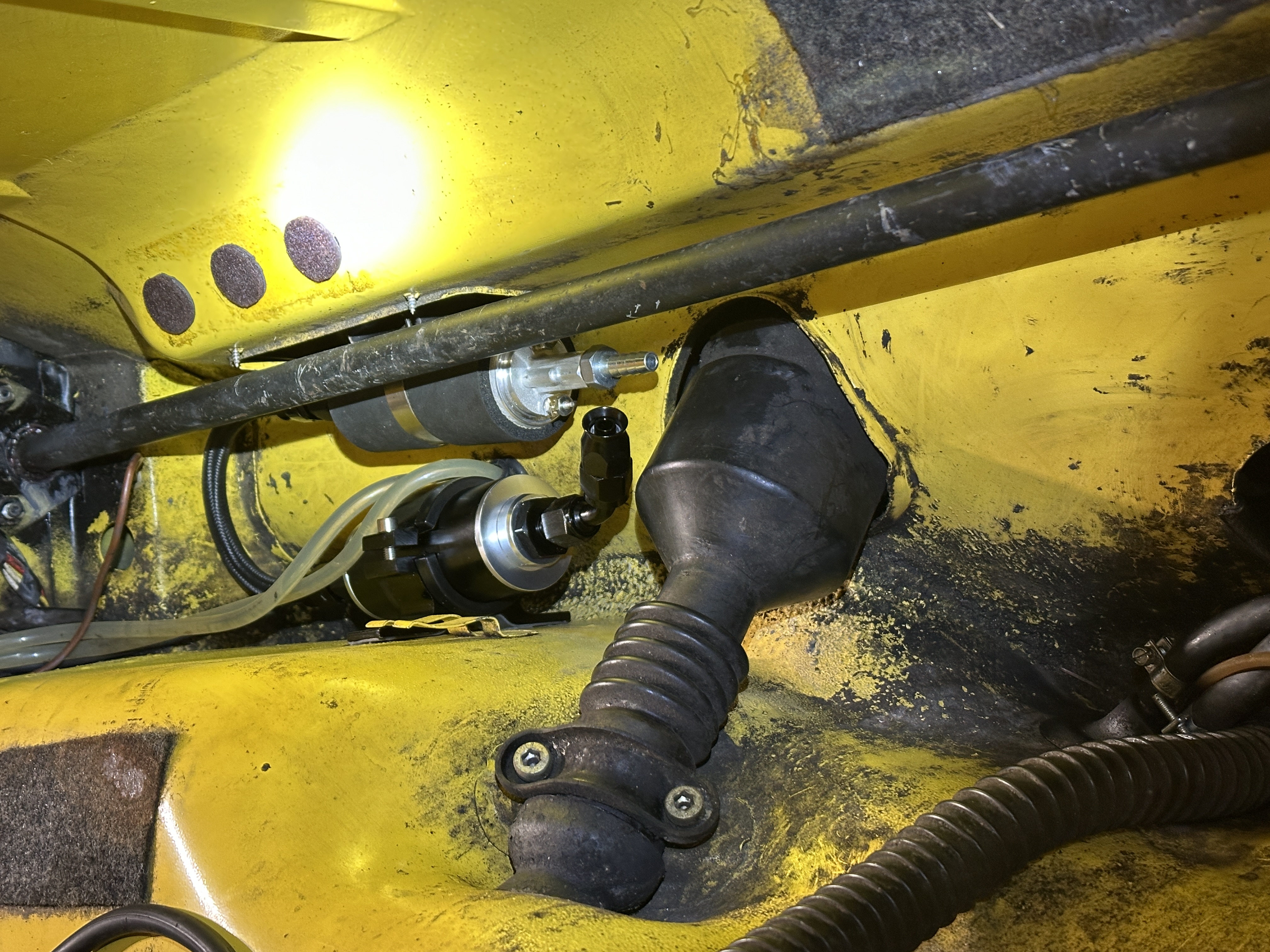

rfinegan
post Dec 1 2025, 01:13 PM
Posts: 1,164
Joined: 8-February 13
From: NC
Member No.: 15,499
Evil works fuel filter and 6-an linesAttached Image
still more lines to make....

If you are updating things:
NO pre pump filter aside from the tank screen.
10 micron high pressure post pump filter
I've been using these but you can get that one you posted with a 10 micron element as well.
https://www.summitracing.com/parts/sum-230123b
Cleanest fuel with the least amount of flow restriction. Late style bosch 2 port pumps will handle this no problem. you want the step up from the 10mm line to the 12mm line as close to the tank as possible. Or just change out the tank fitting itself.
and before anyone bitches about not having a pre pump filter, this is the configuration Volkswagen moved to in the 80s with this pump to address cavitation on the intake side. you want as little restriction as possible between the tank and the pump.
