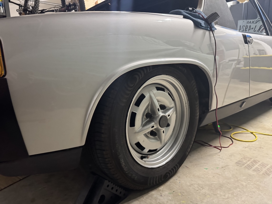

As of right now, I've adjusted to get fender heights match side to side when comparing the front or the rears. I should also mention the rear fenders are about 1.5" from the top of the wheel rim.

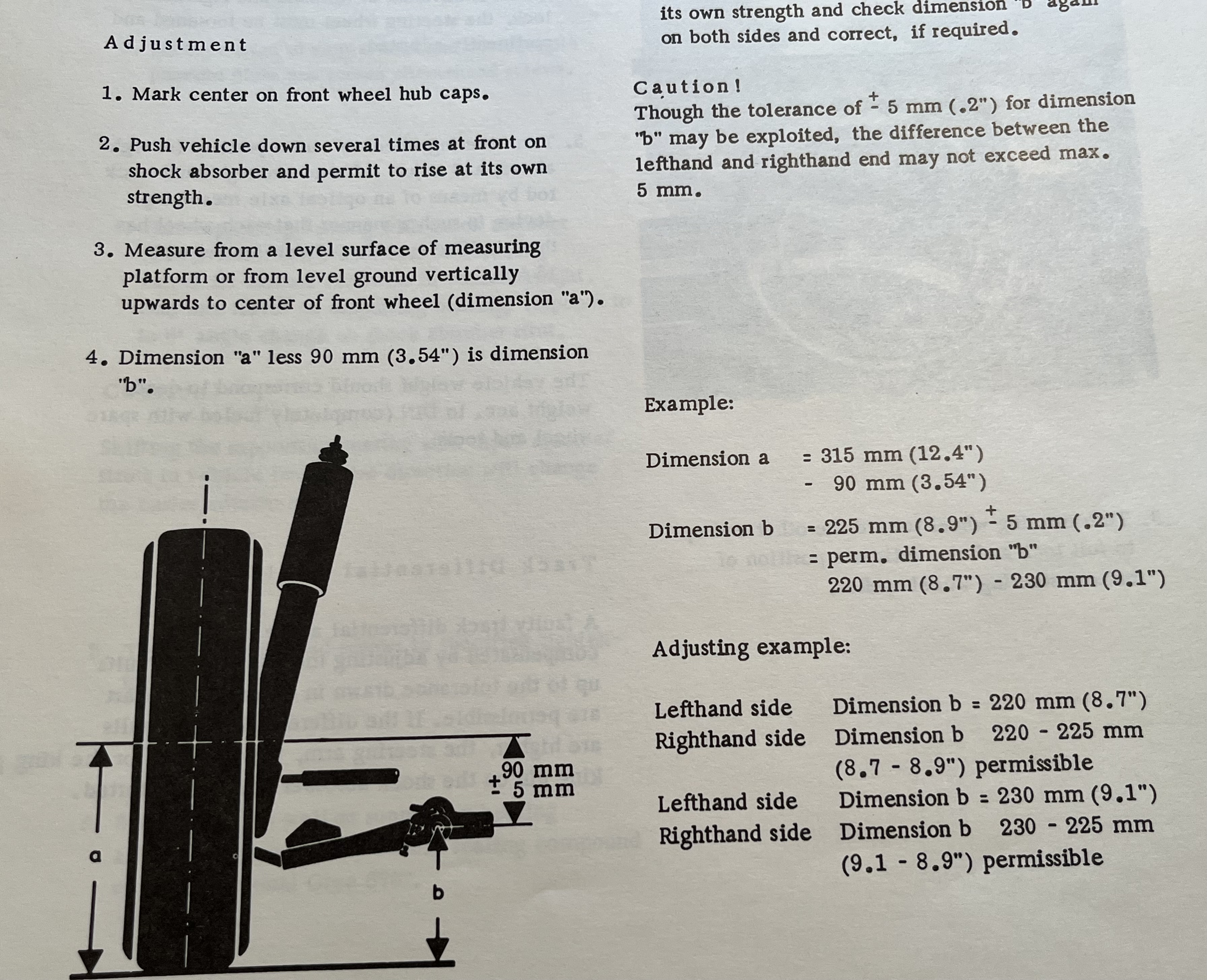

Center of the wheels measure right at 12" and the torsion cap is 7.5" (center to ground). Based on the manual I should technically need to raise the front to get back to within factory specs, but I know the car isn't running factory springs.

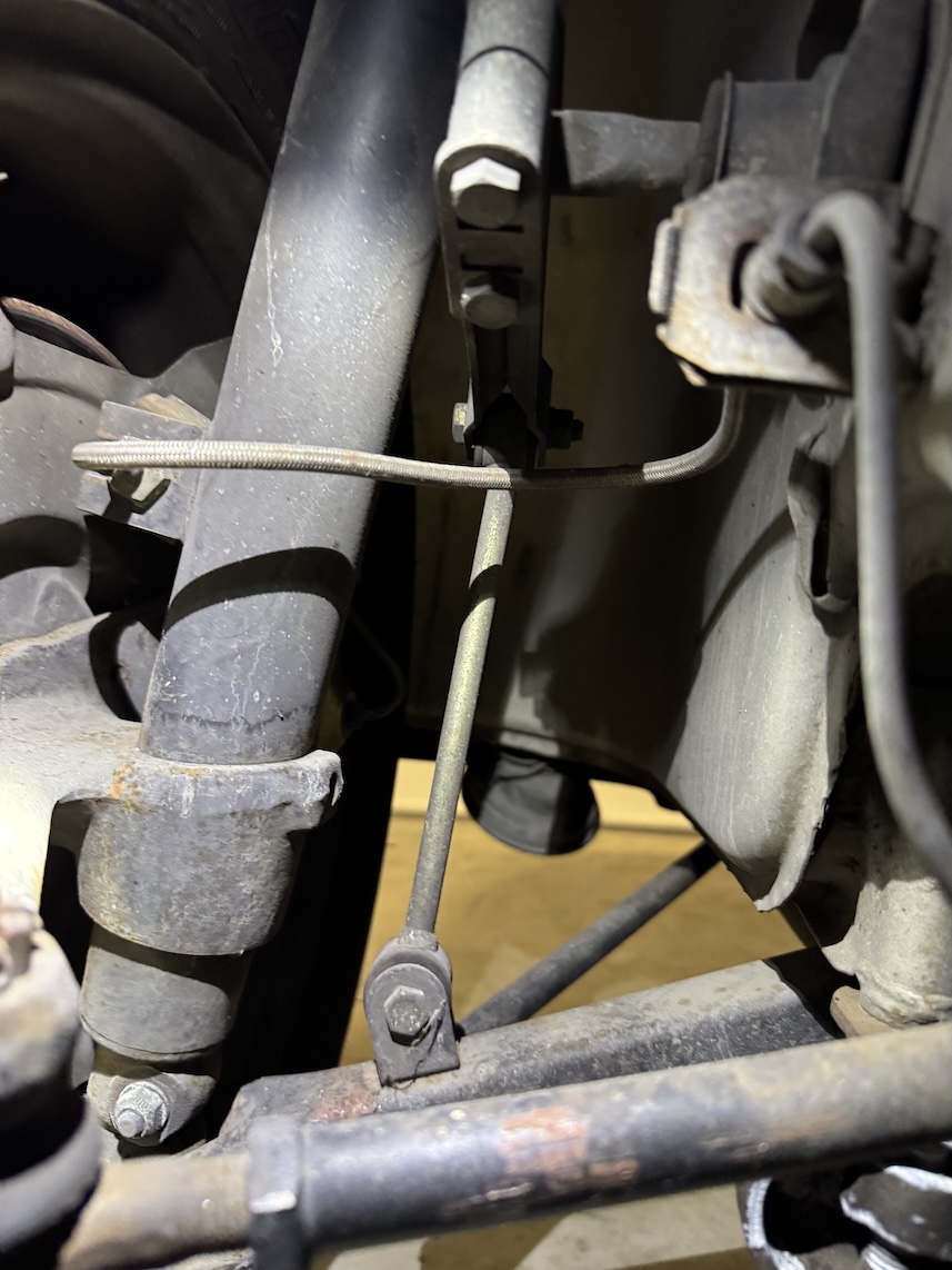

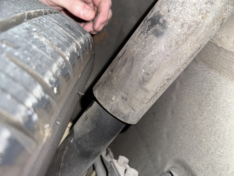

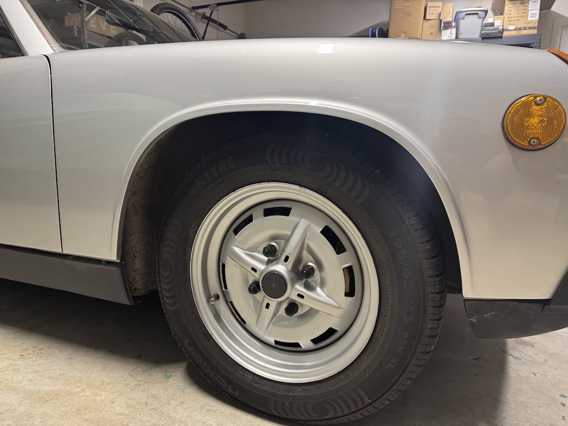

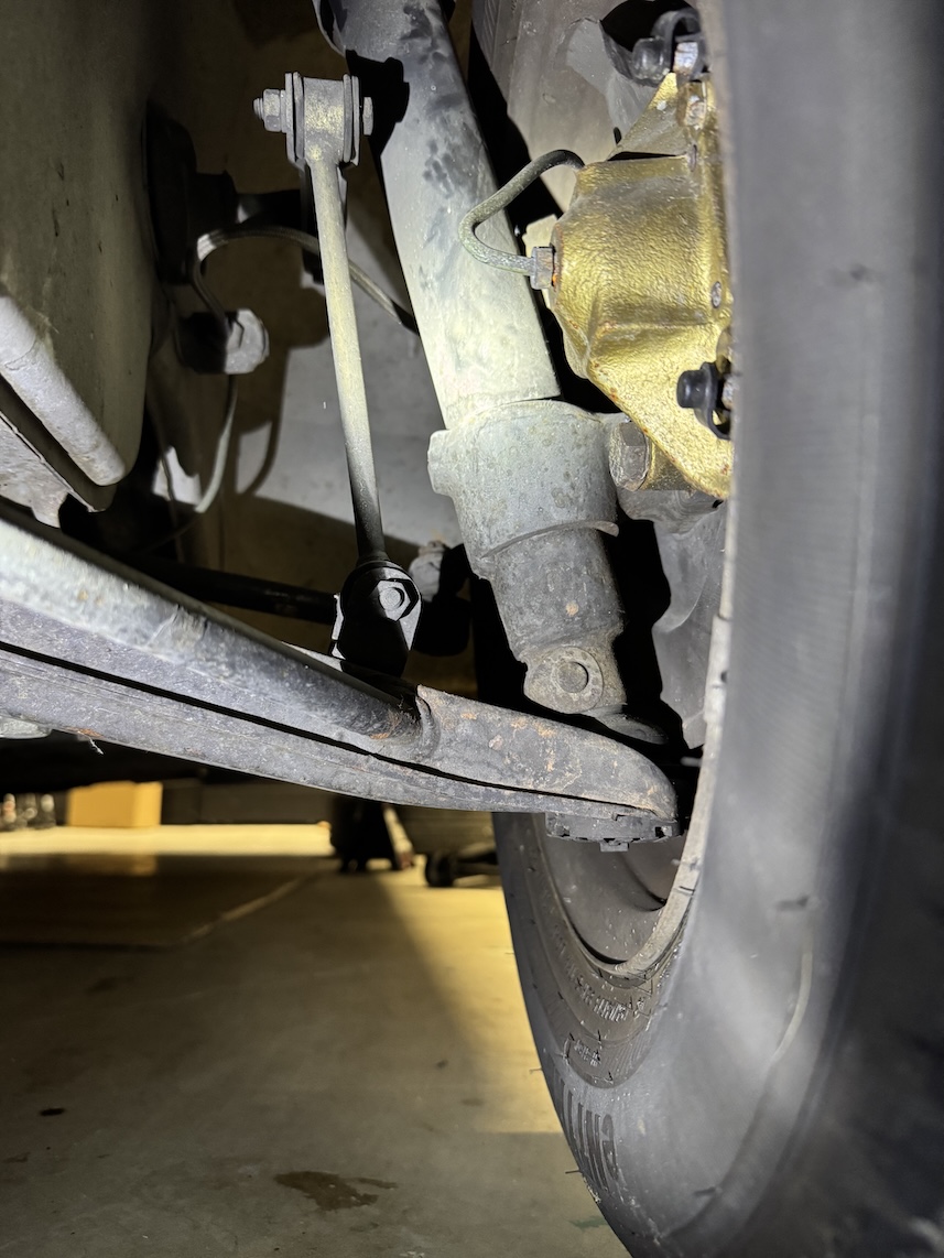

Thought I would add a couple pics for reference

The factory ride height is the difference between the center of the front wheel and the center of the torsion spring. The stock number is 90mm +\- 5mm. This is measured with a half tank of fuel and the driver’s weight in the left seat.
Raise the front to unload the torsion springs to make adjustments, otherwise you can break the adjuster screws.

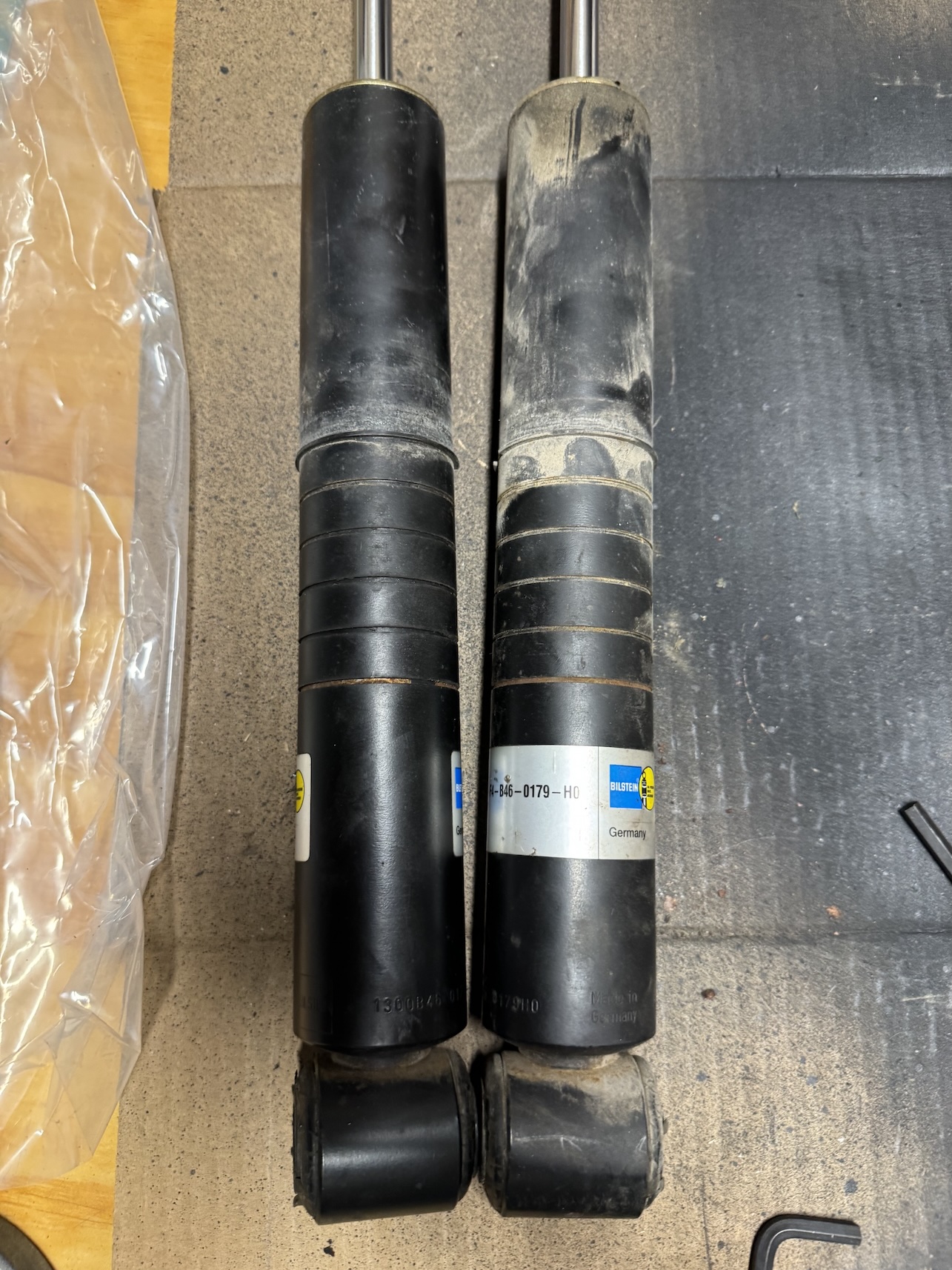

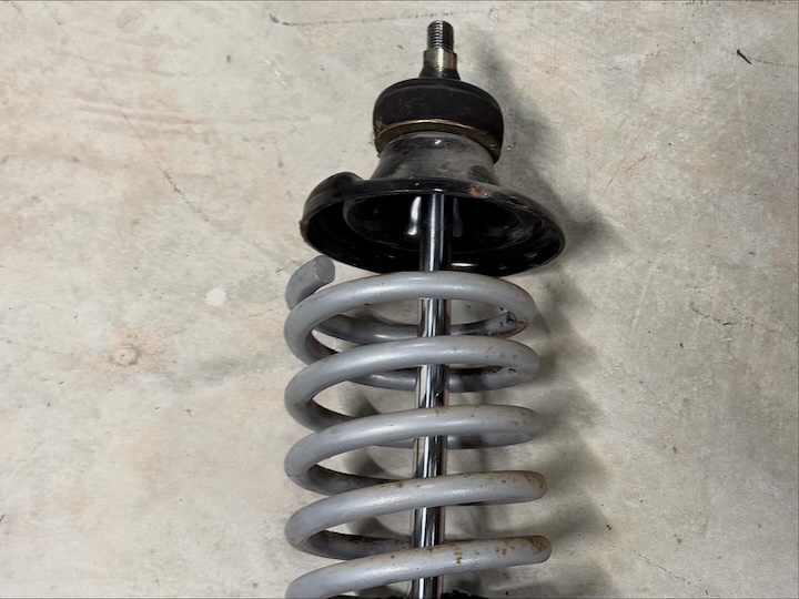

- Does my front struts (last 3 pics) limit me to one brand or another? I can't find any distinguishing marks or paperwork they've been changed. And I keep reading posts that some fit and others don't in the front. From what I have read since they are black, their the Boge style.
- Anyone have experience with 914 rubber springs?

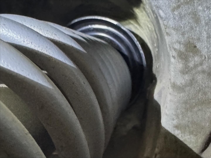

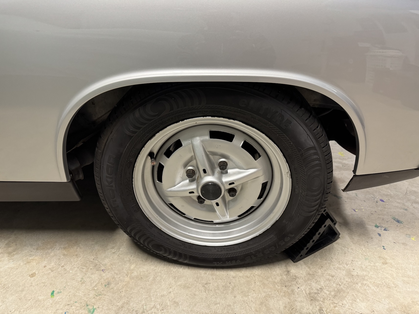

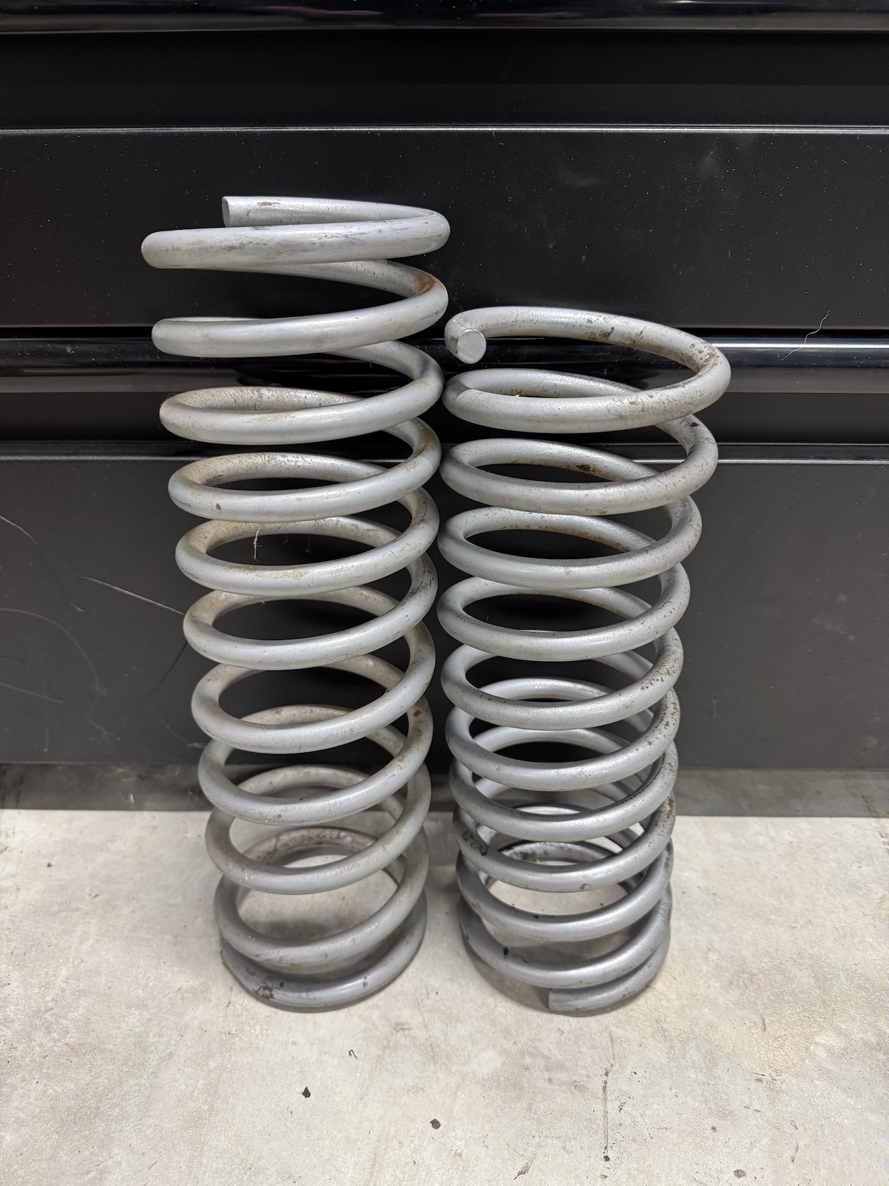

I've swapped out the rear shocks for new Bilsteins (B6) with new springs (100# 914Rubber). Old stuff was shot and springs were actually a different size (pic for reference). I could use some help for those running Bilsteins on their car or what I should aim for to get stock ride height.
What notch should I put the circlip at? I thought I saw something that said 4th from the bottom, but old setup had it at the very top. Currently I have it in the 5th notch. That gives me around 2.75" of rear tire showing. Originally I was around 1.5 - 1.75".
Trying to understand what moving the spring to higher vs lower notch will actually do? I assume if I move it to a higher notch get some rear height added since the spring would be more pre-loaded. What does this do to the ride versus having it lower? If I am just street driving, I assume a coilover kit would be overkill?

Changing the pre-load does not change the spring rate.
