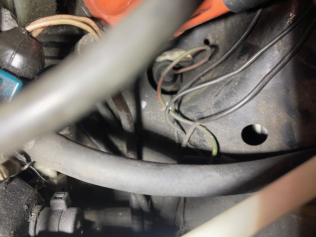

So, its a fully stock 1974 1.8L
https://ik.imagekit.io/bhptmszid/IMG_1928.j...t=1758928645823
trying different ways to add an image but isn't working. so here's an image link.
the white wire (#1) I'm holding is from the main harness, close to the computer.
The two black wires (#2) I'm holding go into one connection.
then there's a green and brown (#3) , brown (#4) , black and red (#5)

This diagram should answer all you questions: https://bowlsby.net/914/WiringHarnesses/doc...74-75_L-Jet.pdf

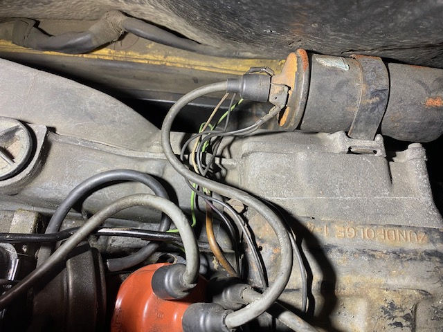

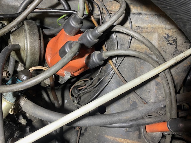

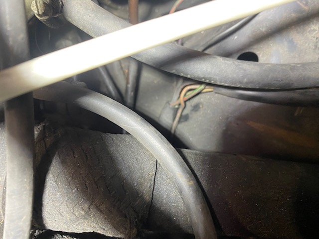

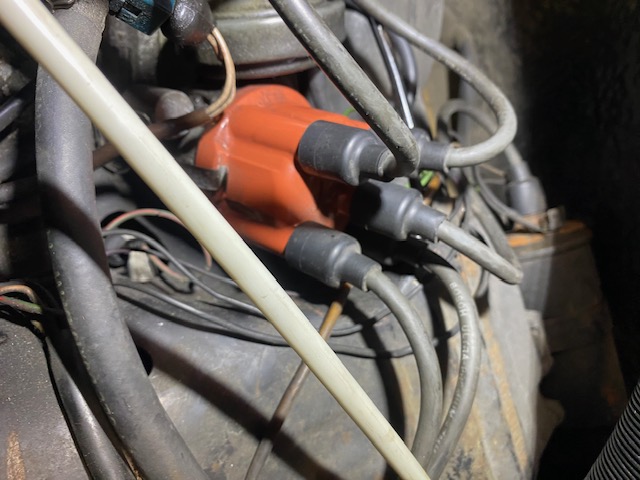

heya, Im responding after who knows how long cause of school and other things. Yea I wouldn't mind a pic of mainly the harness that goes to the ignition coil. Im trying to wire up the engine bay since i put the motor back in, and it seems like there was a crackhead before me that flipped everything on its head and nothing is in place..
Ignition coil is the last thing before vacuum hoses.

Just seeing this now. If you tag someone in a post they will get a notification that you were trying to get their attention. Like this: @Matthewk
Here's a few photos. Tried to follow the wiring back from the coil. Maybe not the best sequence trying to do it one handed, holding a light in the other hand, and pulling back hoses... If you need anything else, or better pics, let me know.
