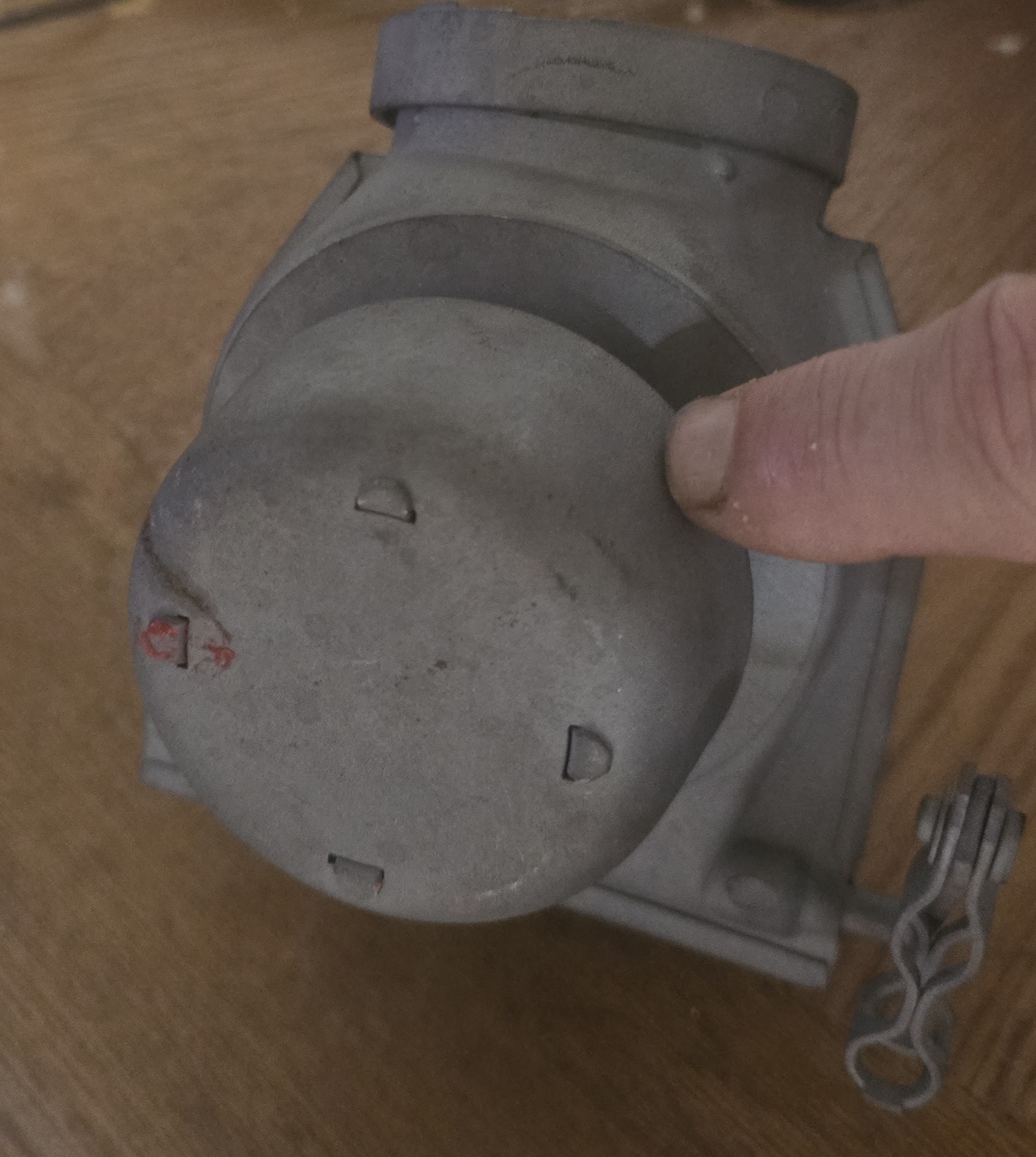

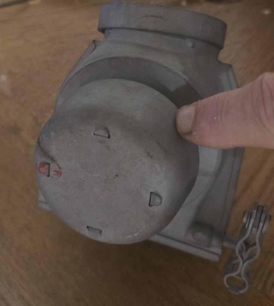

I think he means the Heater flapper valve hat
But I don't know why you need one if doing the vapor lock update which removes it.
@s13u74cr4
Like this?

Ohh, I mean the other side that would go into the hose-->opening in the firewall for the heat. I thought the dust cap would fit either side but maybe not? Regardless, something to cap off the other side of the box.

The heater valve Bruce is showing is connected to the tube that lives in the long via a flexible duct. There is no cap there.
What some people have been using to cap off the inlet tube (longitudinal) is a rattle can paint cap.

You can buy an expandable rubber plug off Amazon. It has a bolt in the center that expands the rubber. I did not find paint cars fit well and you have to fashion some kind of clamp to keep them on.0
