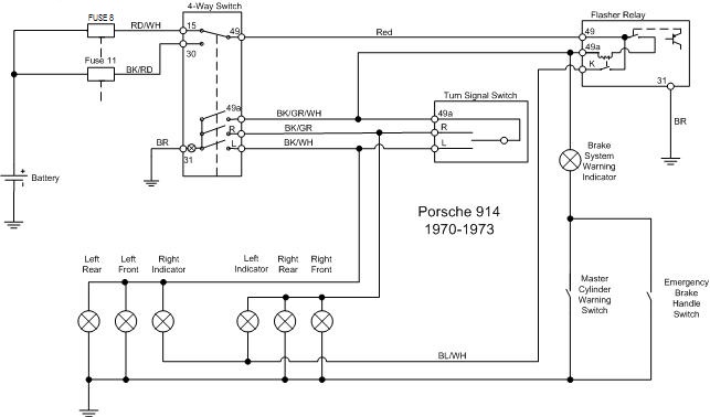

Here’s a simplified schematic from Spoke
The circuit is basically a switched ground.
So when either the park brake switch or the master cylinder switch are closed and connected to ground - the warning light begins to flash.
The wire coming up from the master cylinder switch and parking brake switch is brown / white (early) or brown / yellow (late). There may be two wires tied into a single spade (I don’t have a late car) at the back of the bulb. If there are two wires into a single spade - we will have to get more creative to determine if it’s the parking brake switch or the master cylinder switch causing the issue (let’s deal with that later) What year is your car - assuming late based on you saying brown/yellow.
These wires can be found on the back side of the gauge connected to the lamp.
Use the multimeter to measure resistance between a good chassis ground and the Brown & yellow wire. Should be infinite / open assuming your master cylinder and/or parking brake switch doesn’t have issues. If it is near zero ohms - that is going to cause the warning lamp to come on and flash.
The other side of the bulb ought to have a wire with three colors (brown/green/white - late) which is the 12v(pulsed) feed that comes from the flasher relay. Don’t worry about that for now - only mentioning it to help you identify which bulb and wires you are looking for.
