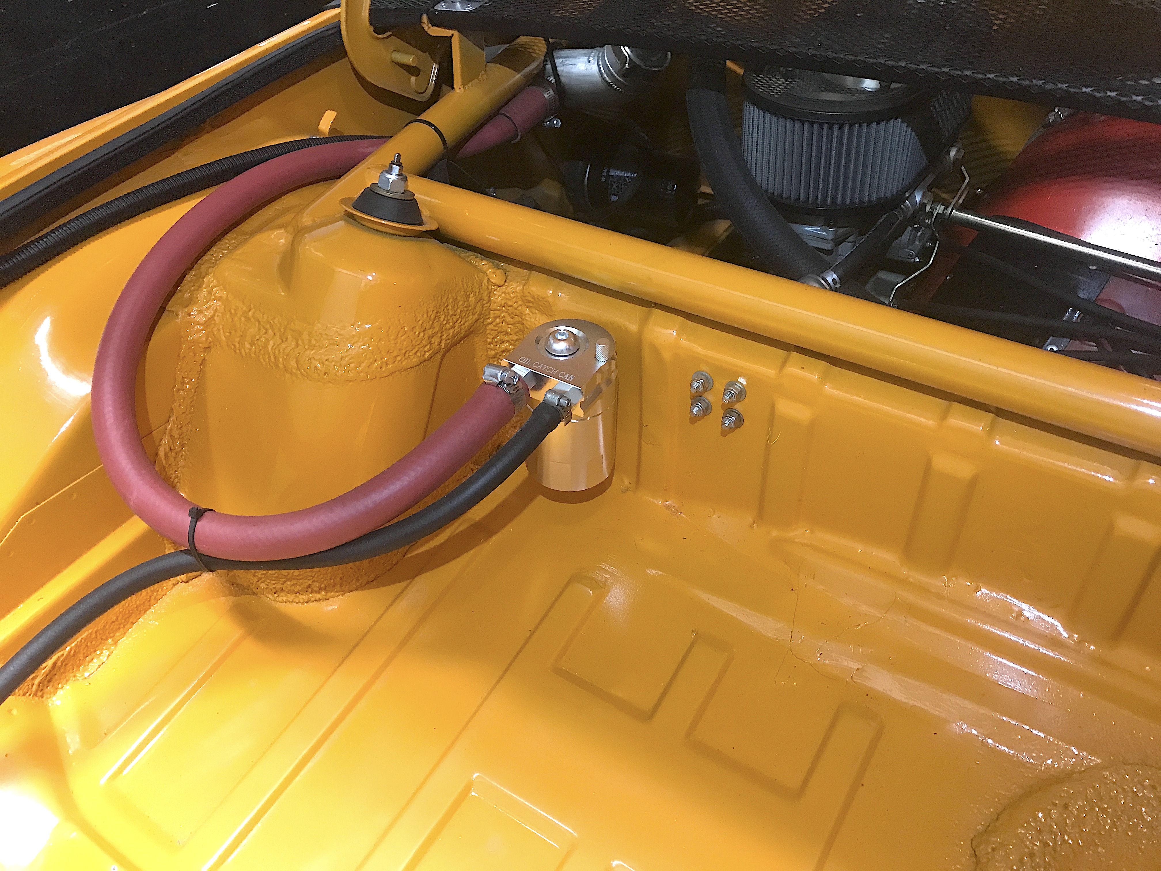

post Aug 21 2025, 07:38 AM
Posts: 1,698
Joined: 11-November 11
From: Merrimac, WI
Member No.: 13,770
QUOTE(mb911 @ Aug 13 2025, 10:38 AM) *
QUOTE(bdstone914 @ Aug 13 2025, 05:40 AM) *
The 914-6 we got is missing the air cleaner.
I have after market Individual air cleaners.
Anyone have pictures of how they hooked up the breather lines to non stock air cleaners?
Also looking for an original carb type air cleaner.
I would suggest not. The engine breather should connect right to the oil tank and the vent on the filler neck should vent to a puke tank in my opinion
I'm with Ben, just vent case to oil tank then out to oil catch can then out rear inner fender. This model catch can has a dip stick, no oil yet. works great. MarkAttached Image
