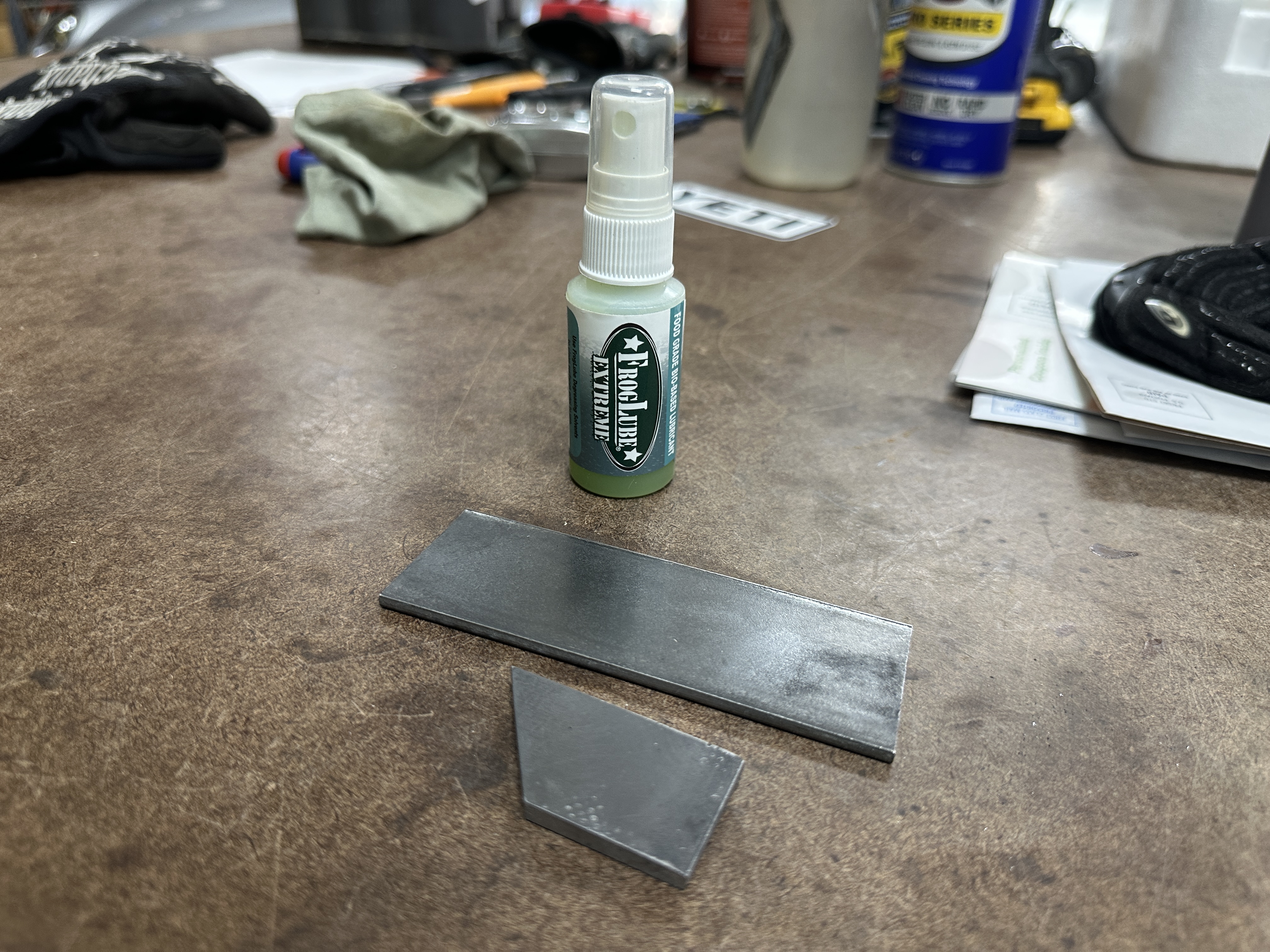

OK, just for you guys I did some science! Or at least some semi-serious testing.
I found two steel bar scrap pieces, and gave them a bit of fine sanding and then polishing. They fit together pretty close (but not a true machined contact).

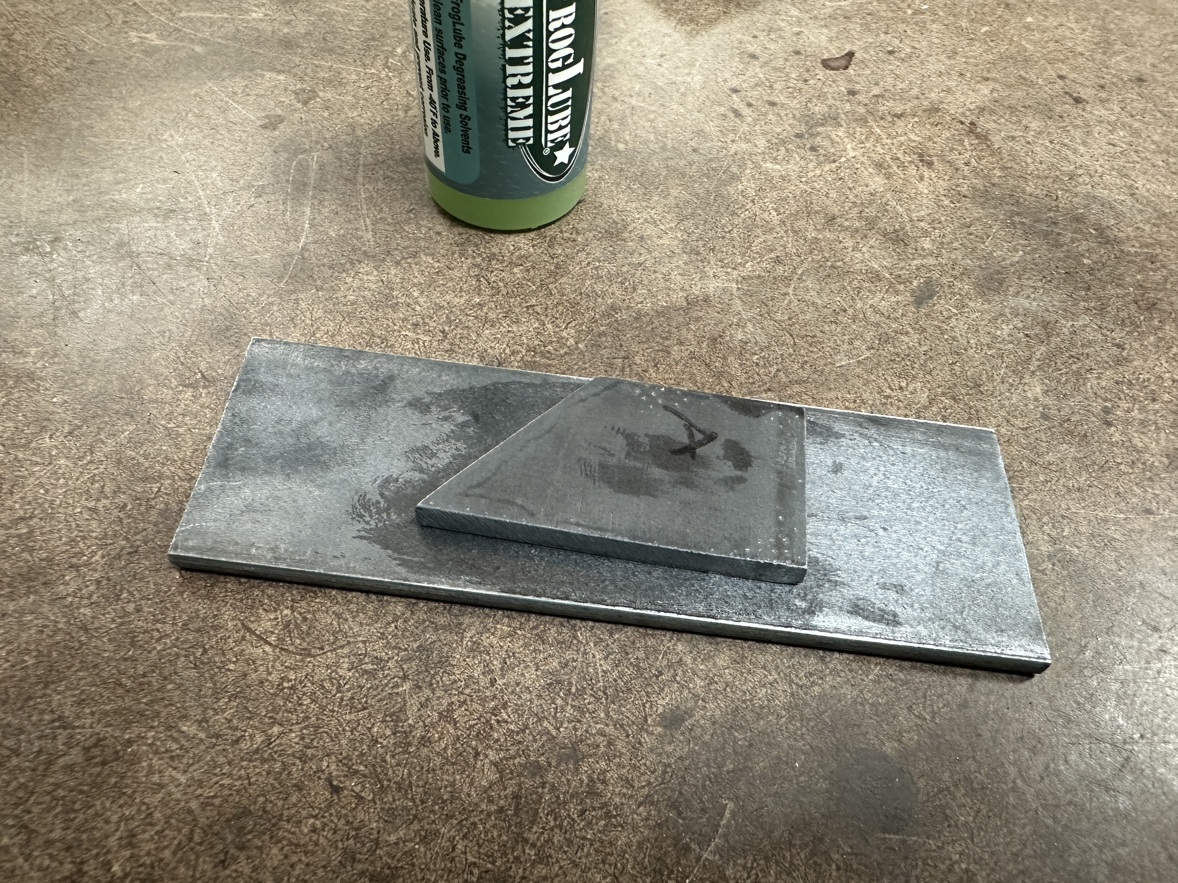

I then put a couple of drops of Frog Lube between the pieces, and slid them around. The joint feels pretty slick. And the contact is wet.

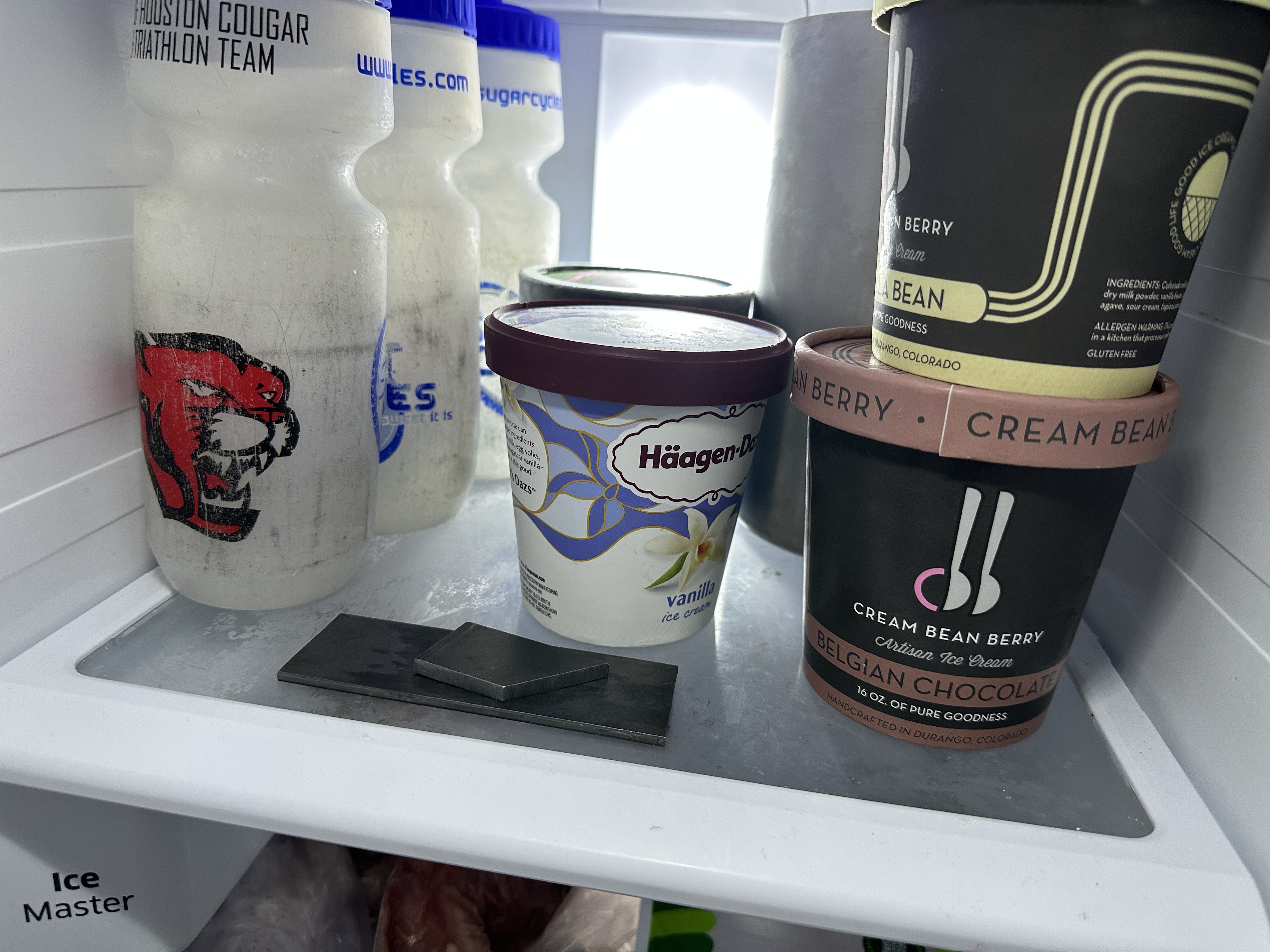

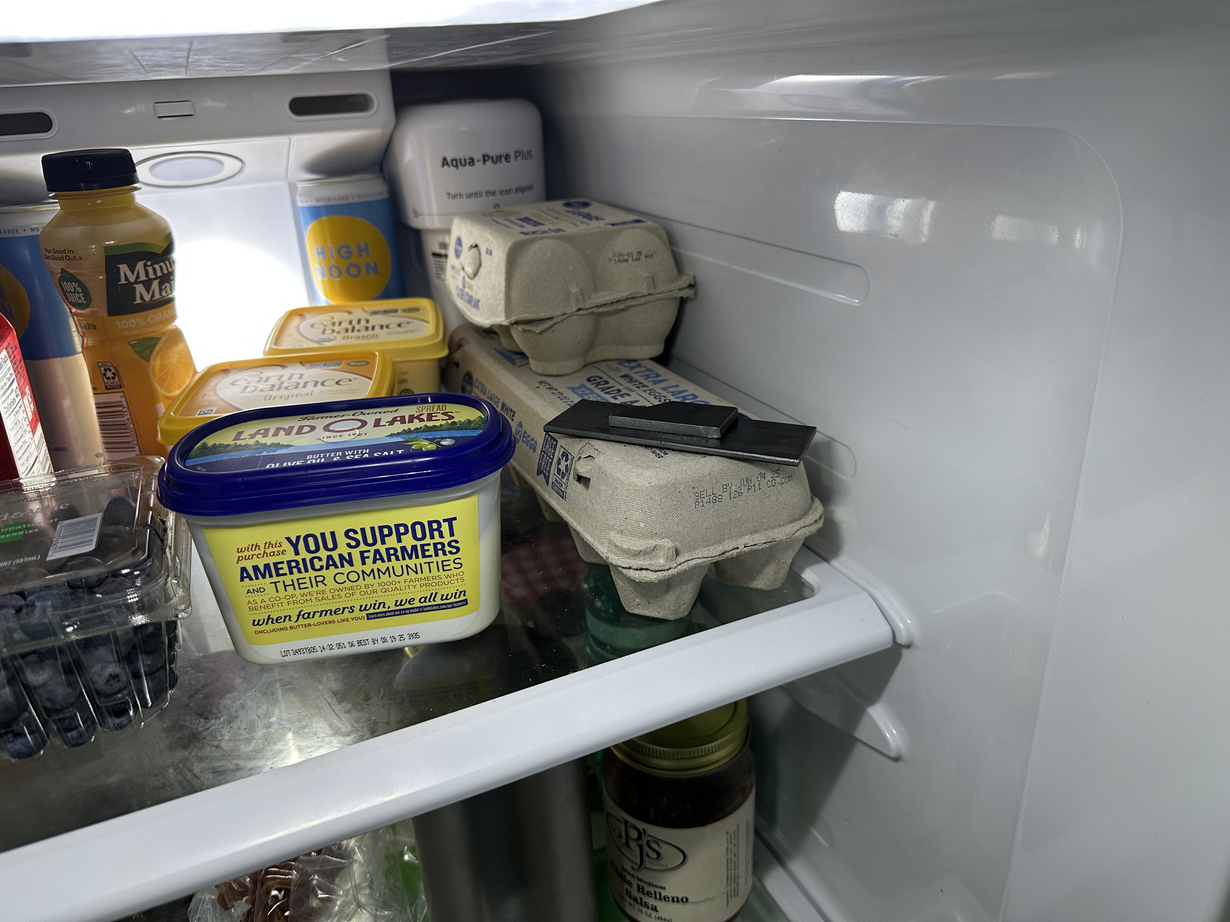

The rig then went into the fridge for a few hours. When I picked it up later, with a very slight tilt, the top piece easily slid off. The still wet Frog Lube was very thin and liquid, no signs of gumming up.

Next, a few hours in the freezer.

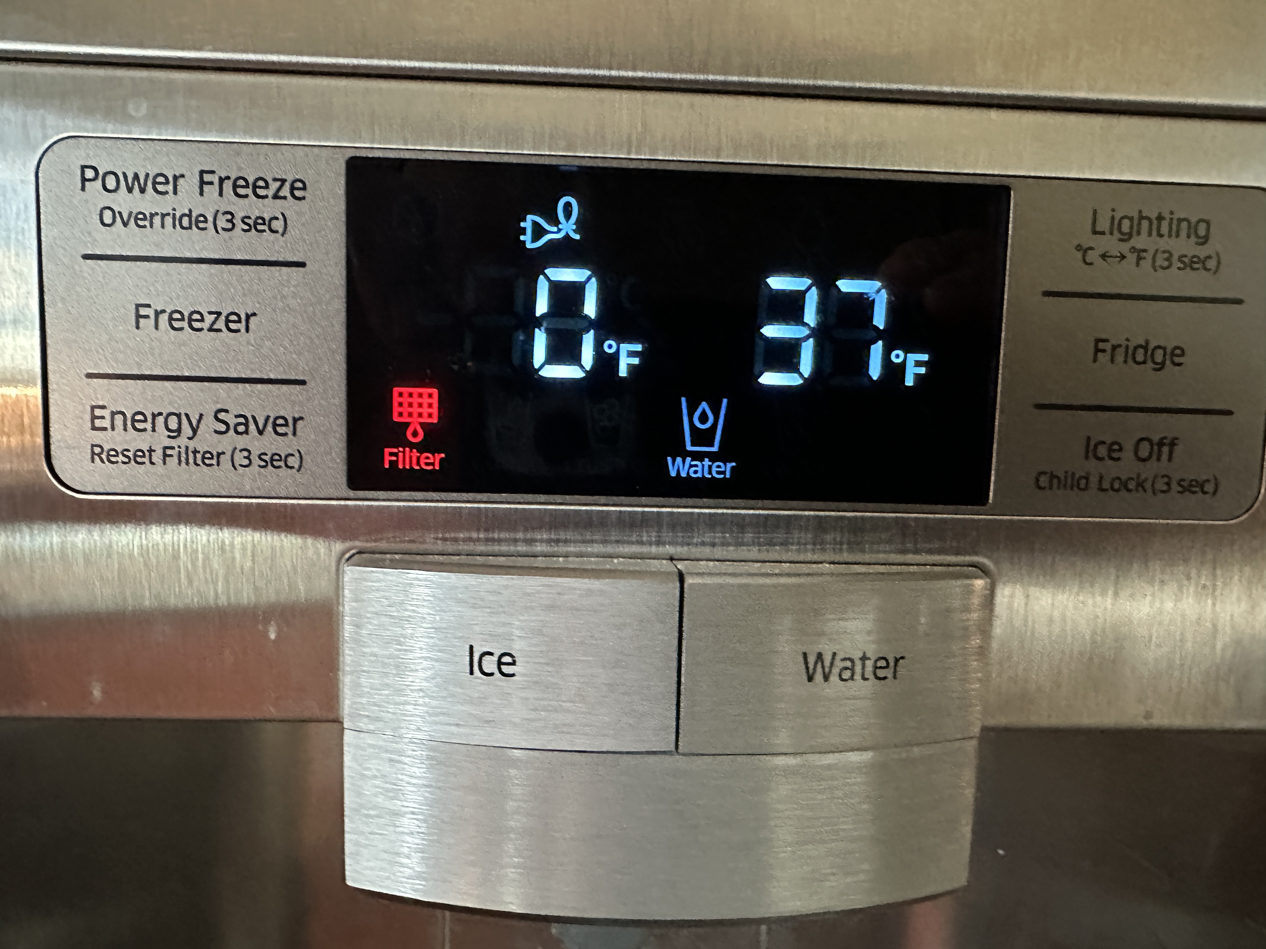

BTW, here are the current temps in the fridge and freezer.
bkrantz
post Jul 19 2025, 08:04 PM
Posts: 8,466
Joined: 3-August 19
From: SW Colorado
Member No.: 23,343

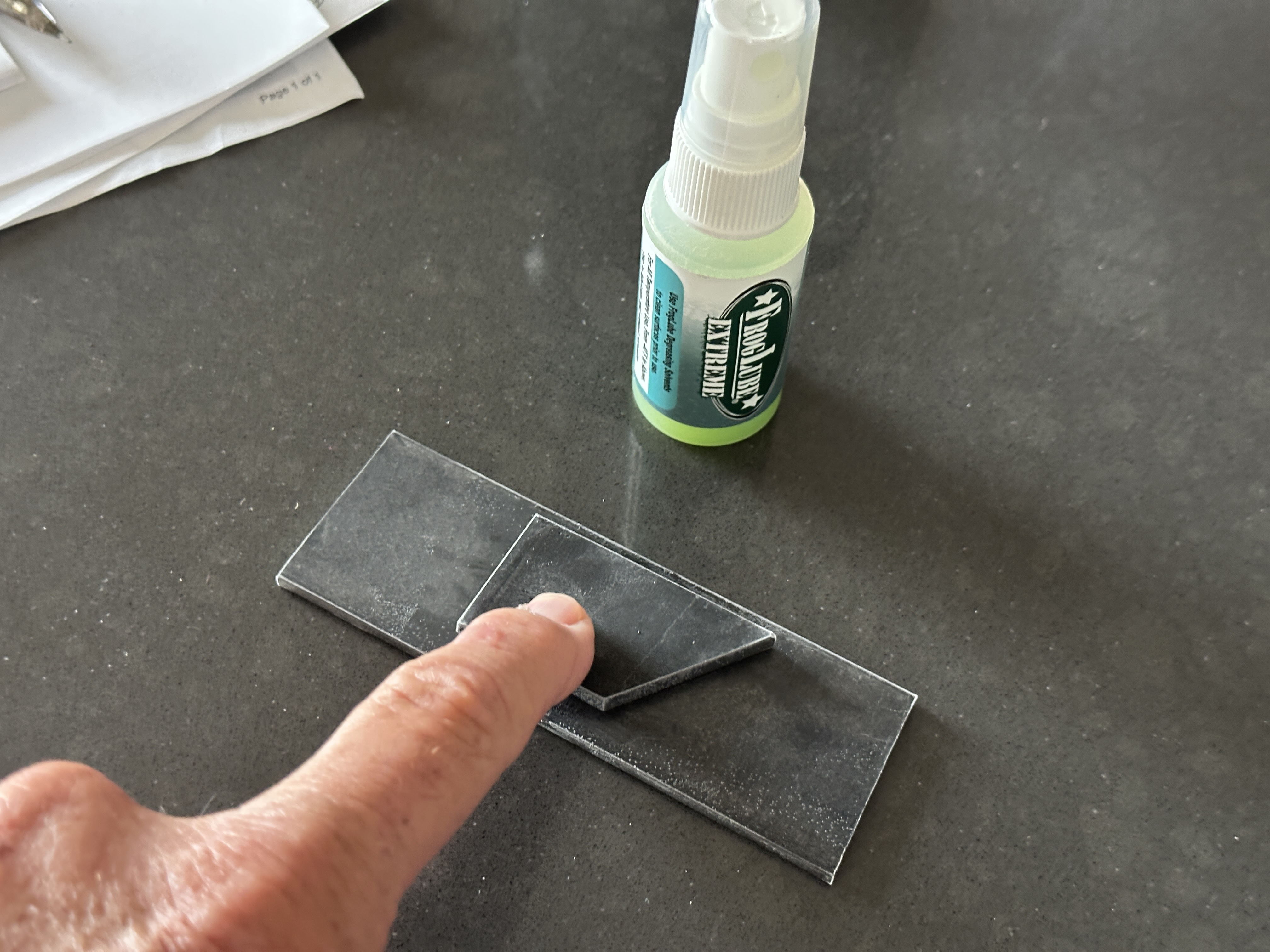

Out of the freezer, and the Frog Lube is still wet and thin, and the metal bits slide easily.
So, maybe not definitive but no obvious thickening, gumming up, or sticking.
