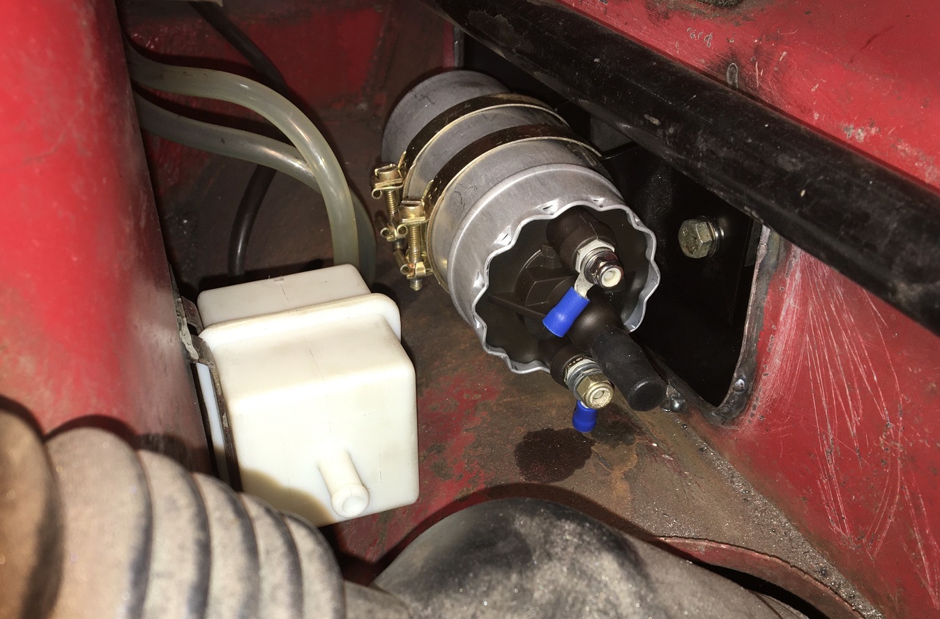

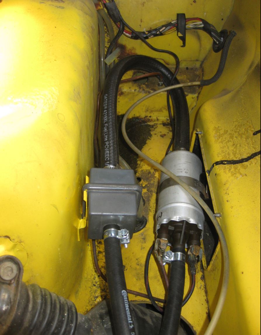

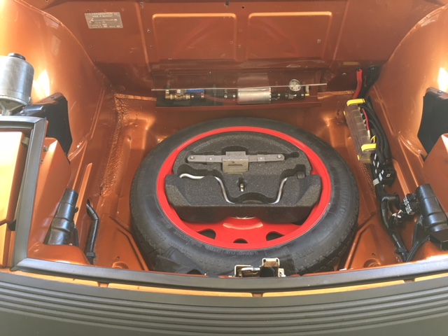

Some pictures from old posts. Not my car
I have the same set up in my early 6 done by PMB Performance
Best Bob B

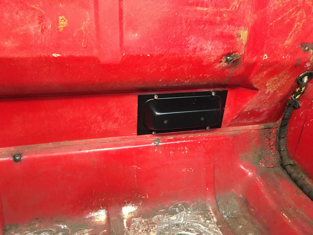

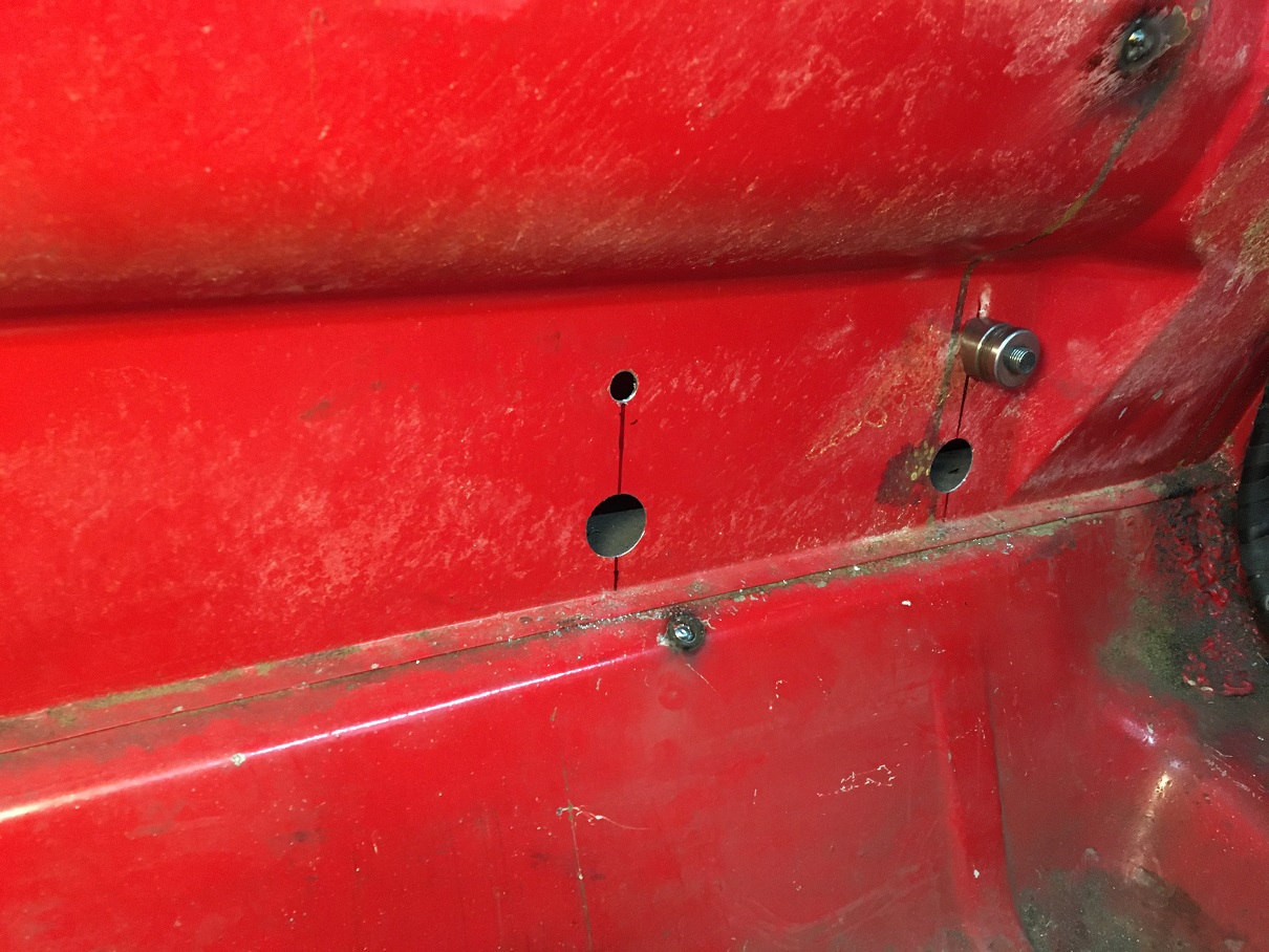

This (IMG:style_emoticons/default/smile.gif)

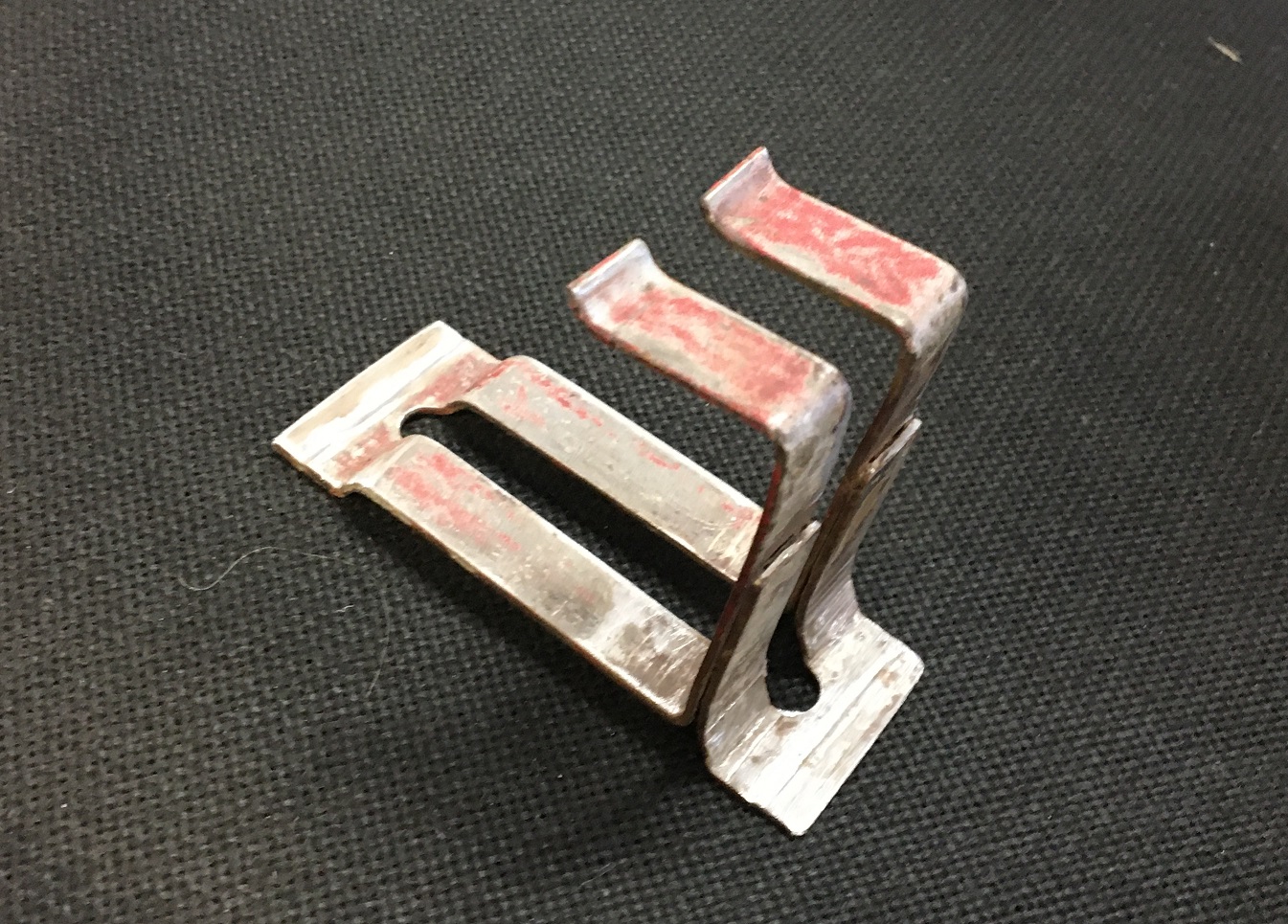

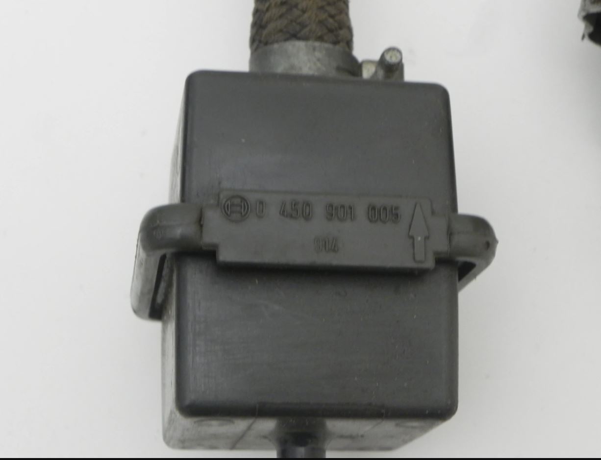

But there are more details to the story. The 75-76 fuel filter have tabs so the filter can be mounted against the cabin/fuel tank firewall as seen on this yellow car.
75-76 filter:
In a 75-76 car:
Unfortunately, those 75-76 filter are very difficult to find and the replacement do not have those tabs to slide the filter on the fork bracket.

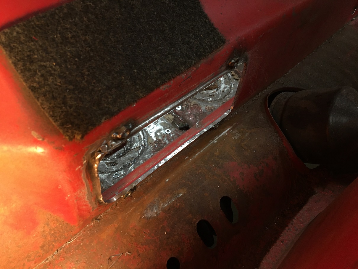

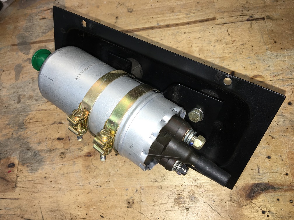

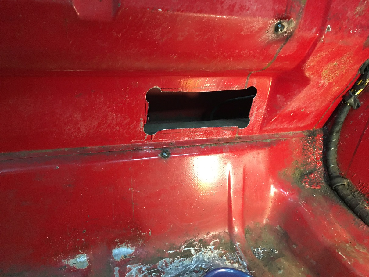

My workaround for the front pump retrofit (or postfit? (IMG:style_emoticons/default/blink.gif) ) was to use the bracket located in the rear of the car and modify it so it can be installed at the 75-76 location. Also the early bracket catches the filter differently so the new ones can be properly installed.
Reworked bracket:
Pump port fab:
Final result with the filter bracket and installed pump. Notice the 19mm sway bar above it all everything clears nicely.

The fuel pump cover door shown in all of these shots above has been icalled a “fuel pump blister”
They came on 1975/76 model years
