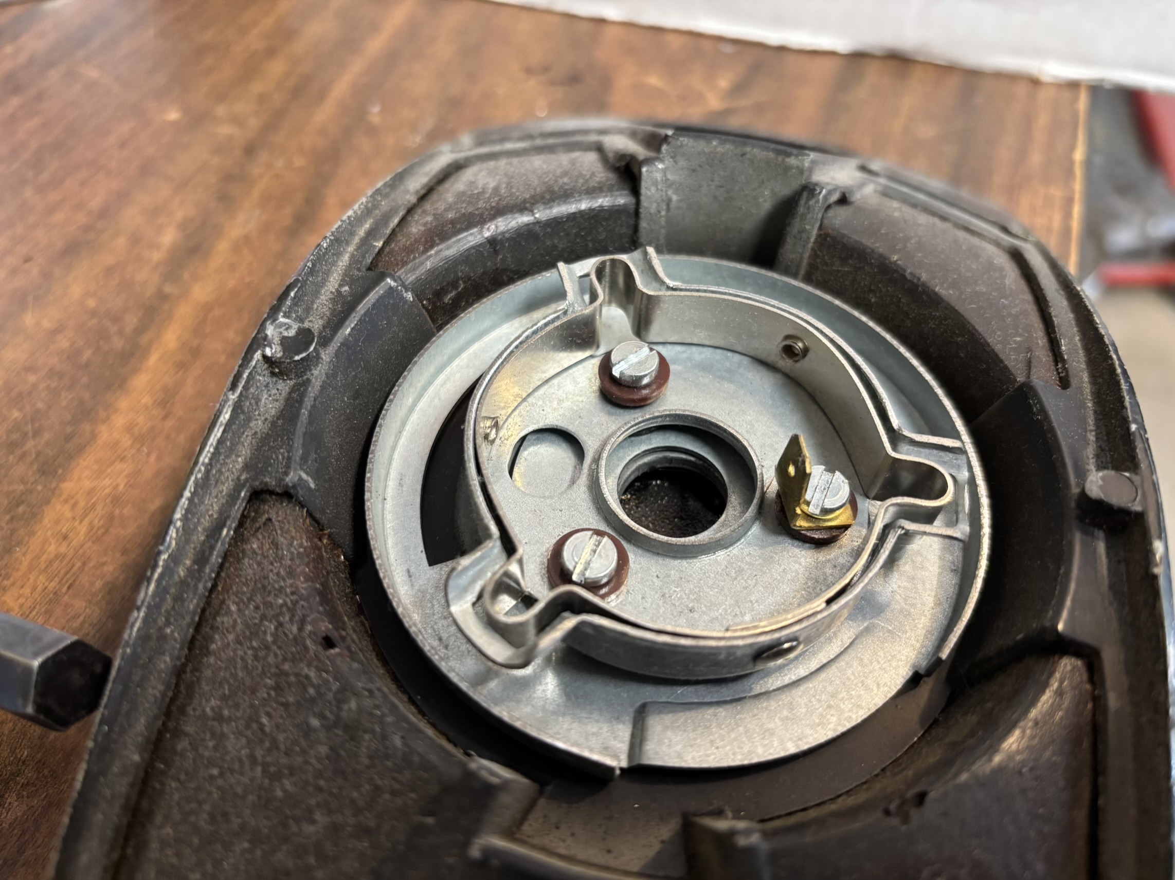

Here’s a picture of my stock 1975 wheel. It has a spade on one of the screws.
ClayPerrine
post Jun 10 2025, 05:21 AM
Posts: 16,526
Joined: 11-September 03
From: Hurst, TX.
Member No.: 1,143
QUOTE(Steve @ Jun 9 2025, 01:03 PM) *
That spade is mounted to the screw, not the horn ring. If you hook that to the horn wire, the horn is going to sound all the time.
