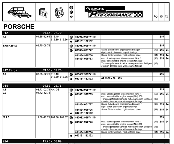

post May 13 2025, 08:02 AM
Posts: 7,113
Clutches and pressure plates don’t care about horsepower. Torque is what matters
914/6 2.0L was about 120 lb-ft
914/4 2.0L was about 116 lb-ft
This is why the /6 and /4 share the “kit”
Sachs and others publish the torque specs of their hardware if you’re doing something outrageous. Chart below is for standard clutch materials. Other friction and pressure plates available if you need more capacity. Attached Image
Max torque: 250Nm =184.391 lb-ft
