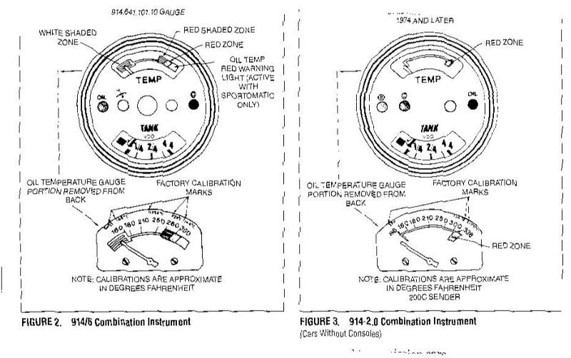

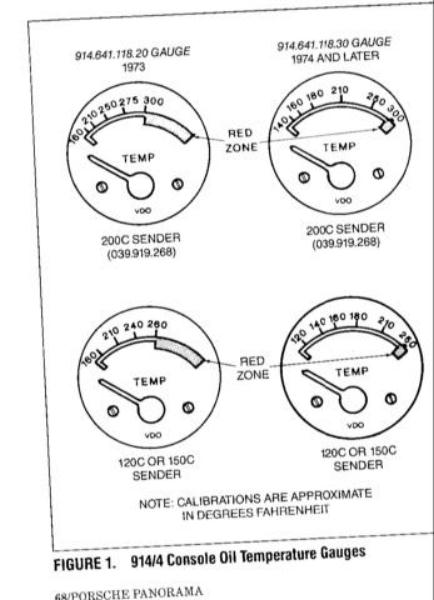

I am trying to troubleshoot what I think is a lazy temperature gauge response on my car (European 1973 914-4 with combo instrument) which has been in storage for far too long.
The temperature needle does not go above about 1/4 way across even with the engine warm. Either that´s normal, or the gauge is out of calibration, or there is a problem with the sensor, or possible combination of all of the above. What is the expected resistance range of a working temp sensor in the sump? I suspect its the long snout type 200C sensor which is fitted since the taco plate has the angled sensor mount. Also how to test the temperature gauge itself? |

Superhawk996 Pretty normal for an early gauge with the proper 2... May 9 2025, 01:14 PM

Lockwodo The oil temp gauge on my ’74 2.0 barely moves wh... May 9 2025, 01:48 PM

emerygt350 Same here. Only time the gauge moves up past 1/4 ... May 9 2025, 02:37 PM

bkrantz Yup. Stock "normal" looks low, and take... May 9 2025, 07:16 PM
reynoldslh Thanks to all for confirming that my temperature g... May 10 2025, 06:35 PM![]() ![]() |
