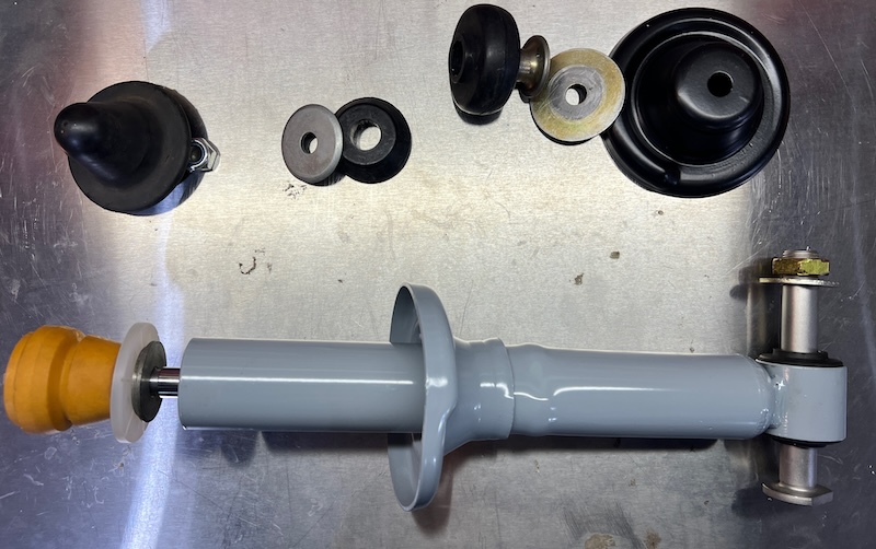

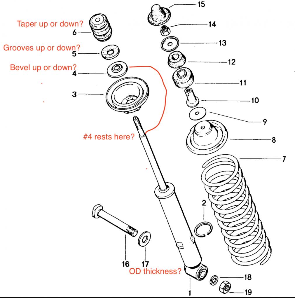

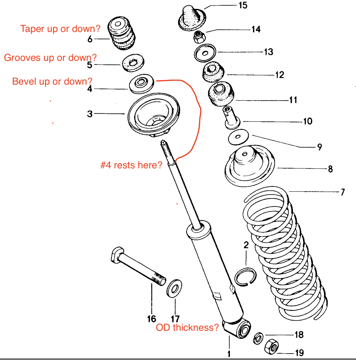

I hate to belabor the rear shock topic, but I am stuck. I didn't have the original setup to reference, and I'm not finding much in terms of Boge details for 914-6.
  • #6 Bump stop: Taper up or down? In the drawings and videos I’ve seen, it goes down. When I trial assemble, it seats much better into #8 cap when taper goes up.
  • #5 Rubber stop washer: Does the side with grooves go up or down?
  • #4 Cap - boge: Does the beveled side (i.e., smaller OD side) go up or down? Why does it even have a bevel?
  • #4 Cap - boge: I assume it is meant to rest on the beveled edge of the strut shaft? When I trial assemble (without the spring) I doesn’t seem like there is enough length to get the #10 threaded bushing to start without some serious compression on #6 bump stop. Is this correct?
  • #17 Washer: What is OD and thickness?
Thanks for any assistance.

That is totally wrong but the PET diagram is garbage as far as an exploded diagram goes so that no slam on you.
Washer #5 should have a hole large enough to allow it to slide to the bottom of the damper rod. It goes at the bottom and should basically be resting on the damper body. This is the first thing to go on the damper. The purpose of the slots is to prevent a vacuum from getting formed on the damper seal (inside damper body) when the jounce bumper gets squished under hard compression.
The yellow bounce bumper #6 should have a hole large enough to slide all the way to the bottom of the damper rod.
The washer #4 that you have at the top of the damper rod has a smaller hole - supposed to stay at the top of the damper rod. However it nests into the top spring retainer/perch #8 on PET. You’ll note it is stepped - this will allow it to “nest” into the spring retainer. Smaller stepped side to the top.

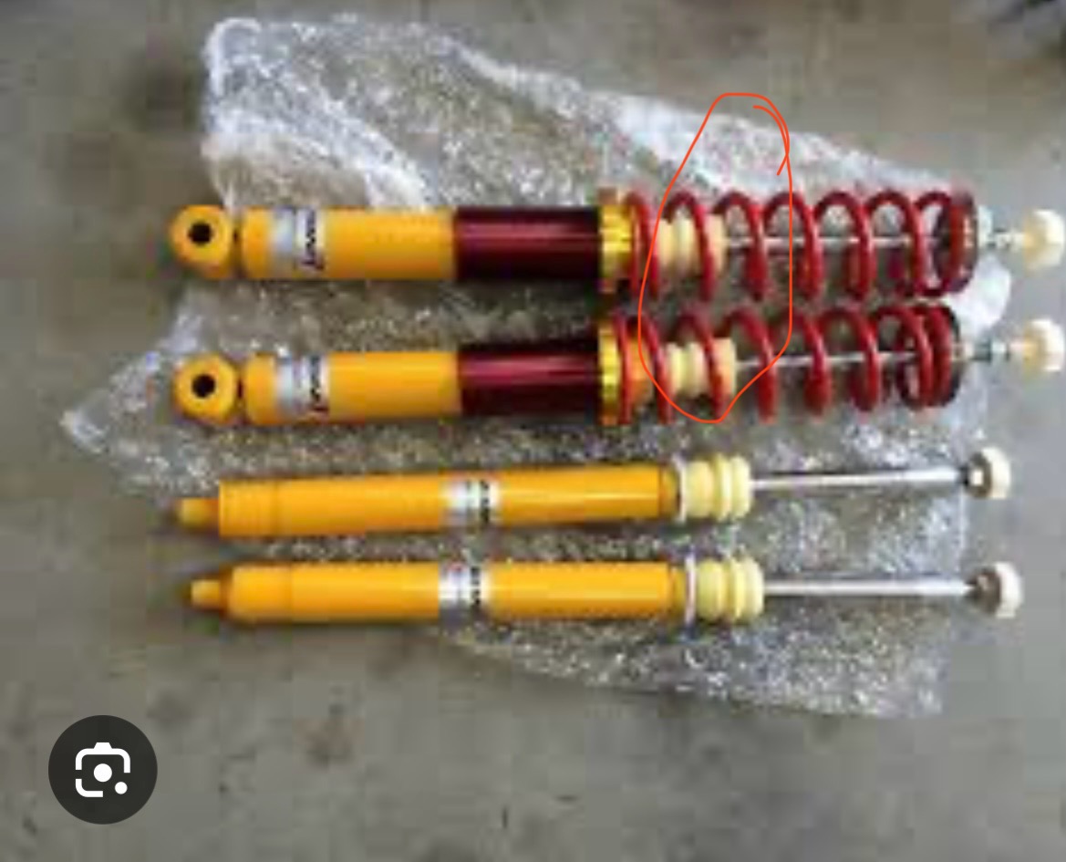

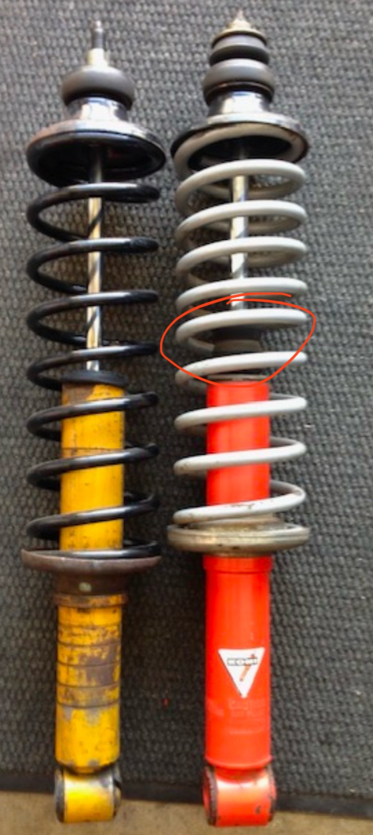

Here’s a couple other pictures of rear dampers and where the jounce bumper goes (circled in red)

Thank you very much for taking time to post this. I think I have it sorted now.
You are correct that I was using the parts catalog as an exploded diagram, which I guess I should not. It was definitely confusing in this case.
The yellow bounce bumper #6 went on all the way down, but required some dish soap and persuasion.

The PET diagram is not too bad if you look at the numbers.
1 the shock body
2 the lower perch retainer (not needed if the lower perch fts on the shock body)
3 lower spring perch
4 dust cap (stamped metal fits over the shock body like a bottle cap) I do not see #4 in the parts in your photos.
5 anti-siphon grooves down
6 bump stop rubber sits on the ledge at the top of the shaft
7 spring sits in bottom perch
8 spring cap
9 flat washer (large)
10 shaft nut (torque down to spec, applies preload to the spring which should not be loose
11 rubber bush fits over # 10 and centers the shock assembly into the bottom of shock tower
The shock assembly is now semi complete and can now be fitted to the chassis
12 rubber bush centers the shock assembly onto the top of shock tower (11 & 12 isolate the shaft from the body)
13 cupped washer (cup faces up)
14 self locking nut (new or excellent used)
15 dust cap

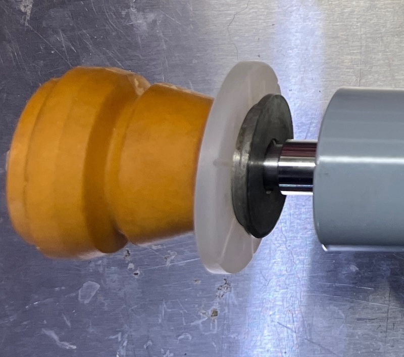

Your shock photos show a stepped washer on the step of the shaft. That is sort of where it goes, but it normally is bonded into the top of #6, and #'s 6, 5 & 4 are below it on the shaft.
When the shaft begins to bottom out #6 bump stop comes into action to soften the blow. When #6 compresses it will seal on #5 and the air inside is forced out. Later the shaft will extend, and #6 decompresses it will suck air into itself; if the grooves in #5 are facing down, then the grooves allow a path for air to reenter #6. If # 5 is not there to provide an air path, then the suction could extract shock oil past the seal on the top of the shaft and eventually ruin the shock.
When you install #10 you will have to compress the spring between perch 3 and cap 8.
The flat washer 17 you have on the pin appears to be about the correct size; it should cover the rubber bushing in the bottom of the shock.

QUOTE(Superhawk996 @ Dec 30 2024, 11:26 PM) *
No, that is wrong! the bump stop (Jounce bumper) does not fit at the bottom of the shaft, but at the top and inside the spring cap.
The original bump stop had the stepped washer bonded into the top of the foam rubber. The bump stop only comes into play when the shaft is fully pushed into the shock and the spring is fully compressed. Its purpose is to keep the bottom of the shaft from slamming into the bottom of the shock body.
davep
The parts diagram is basically numbered in the order of assembly.
As soon as you use the shock in the car, the #6 bumper will ride up the shaft as the spring gets compressed; it is supposed to be up in the cap!
You do not need part #2 since the shock body is designed to support the perch.
I do not see #4.
I do not see a proper #13
The drain hole in the perch #3 should be in the lowest position when the shock is installed, so it will face forward.
Fair enough - may have been that way on OEM part in 1970. Good luck finding a OEM jounce bumper with a bonded washer in 2024.
What is going to happen is when the vehicle is driven, the jounce bumper will migrate up the damper rod. Due to tight fit to the damper rod it will end up staying at the top of the rod for a good while (maybe years). It will function exactly as intended.
Eventually years down the road as the jounce bumper gets pounded out, it will become loose and slide back down to the bottom of the damper rod and will still continue to function for years until it finally splits and falls out.
At that point you will be left with the stepped washer at the top of the damper rod - where they all have survived to this day.

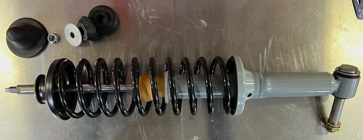

Hi Dave. Thanks for chiming in with additional insight.
#4 When I was searching for parts, I got the impression the stepped washer was #4. So I guess I do not have it. I don't even know what it looks like, much less where to get it. Can you offer some additional details please?
#6 The taper for the step washer goes up. The bump stop rubber below it with taper down. This would make the bump stop on the larger diameter part of the shaft. So if I slide my bump stop rubber up the shaft to meet the step washer, that would essentially be correct?
To say I'm not looking forward to compressing these springs again is an understatement. (IMG:style_emoticons/default/headbang.gif) Best to get it right though.
#6 will still be on the thicker part of the shaft though. So if I just slide it to meet the bevel washer, I am good?

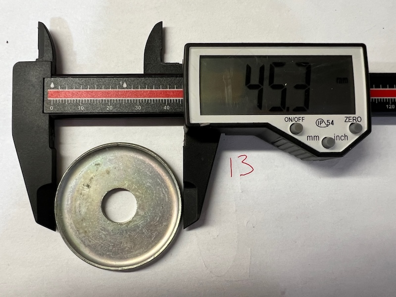

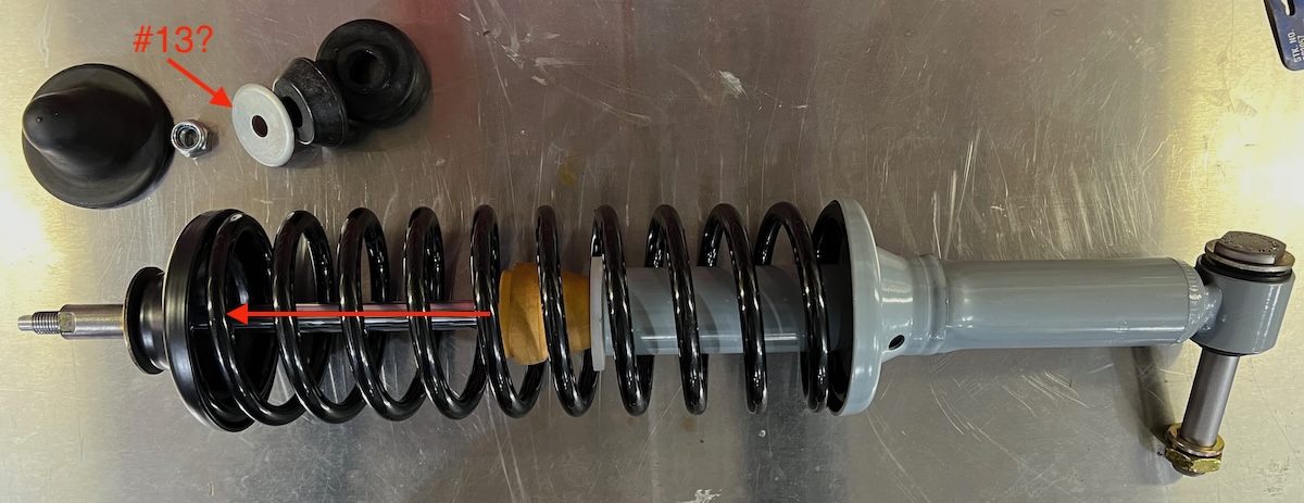

I thought the washer with the curved lip top left was #13? Is it not? The lip isn't easy to see in the photo.
Thanks for the info on the drain hole position.

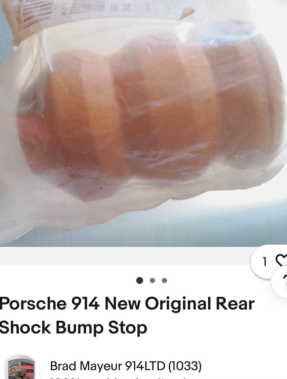

Was trying to find a NOS rear jounce bumper to see if I could find one with the bonded washer in it. Honestly, I’ve never seen one with a bonded washer going back to the 80s when I was working on a lot more 914s than I do today. All I’ve ever seen is loose jounce bumpers and stepped washers that never looked to have been bonded to anything.
Here’s a couple pictures of a NOS part on eBay in Porsche bag and with Porsche part number from Brad Mayeur. Unfortunately no top end view.
Not saying Dave’s wrong, I was just trying to figure out what OEM really was since I’ve never seen a bonded jounce bumper in person.
Edit: In fact, it would seem @Davep is absolutely right!!
Thanks for teaching me about something I’ve never known about 914s!!! Brads listing states “No Longer Available. This is the correct, original bump stop that incorporates the “stepped” washer in the buffer. ” I guess there is exactly one available in 2024 (well now 2025 (IMG:style_emoticons/default/laugh.gif) )
Anyone else have a NOS part picture of the end view with the washer incorporated? Would love to get what it looks like documented before these parts just disappear.
Unfortunately Brad only has this one, otherwise I’d buy a pair of NOS just to see the end not shown in the photo. @ltd914. I’d love to have a set of NOS for my project but think any NOS parts ought to go to Dennis’ /6 restoration before I’d waste them on my /4 project.

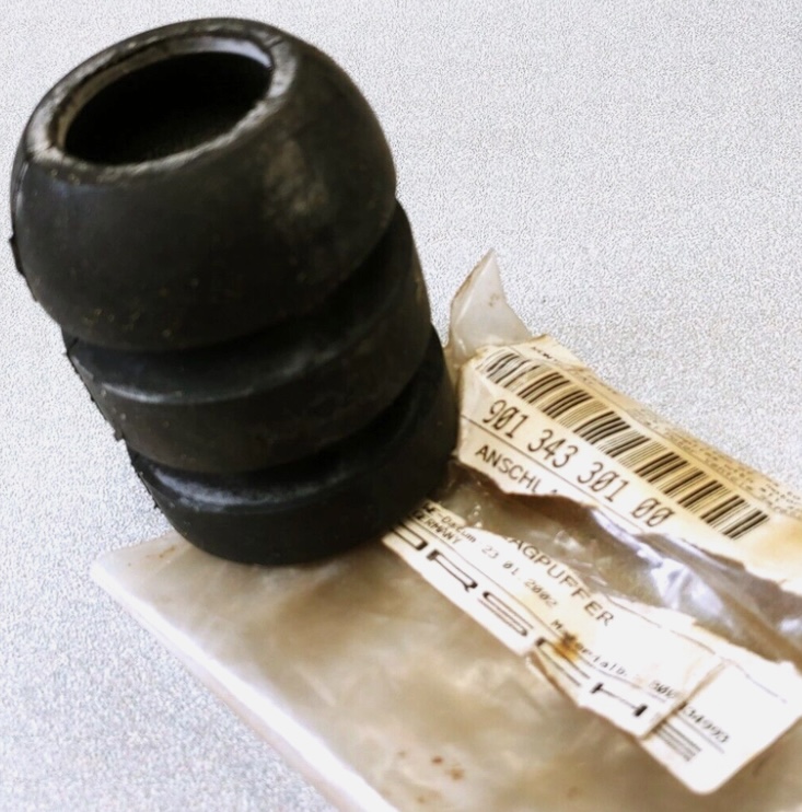

I guess while I’m (IMG:style_emoticons/default/dead horse.gif)
I might as well put a photo of NOS front strut jounce bumper here for anyone stumbling on this thread in future.

QUOTE(DennisV @ Jan 1 2025, 08:25 AM) *
That is indeed #13, but the cup faces up to the nut.
