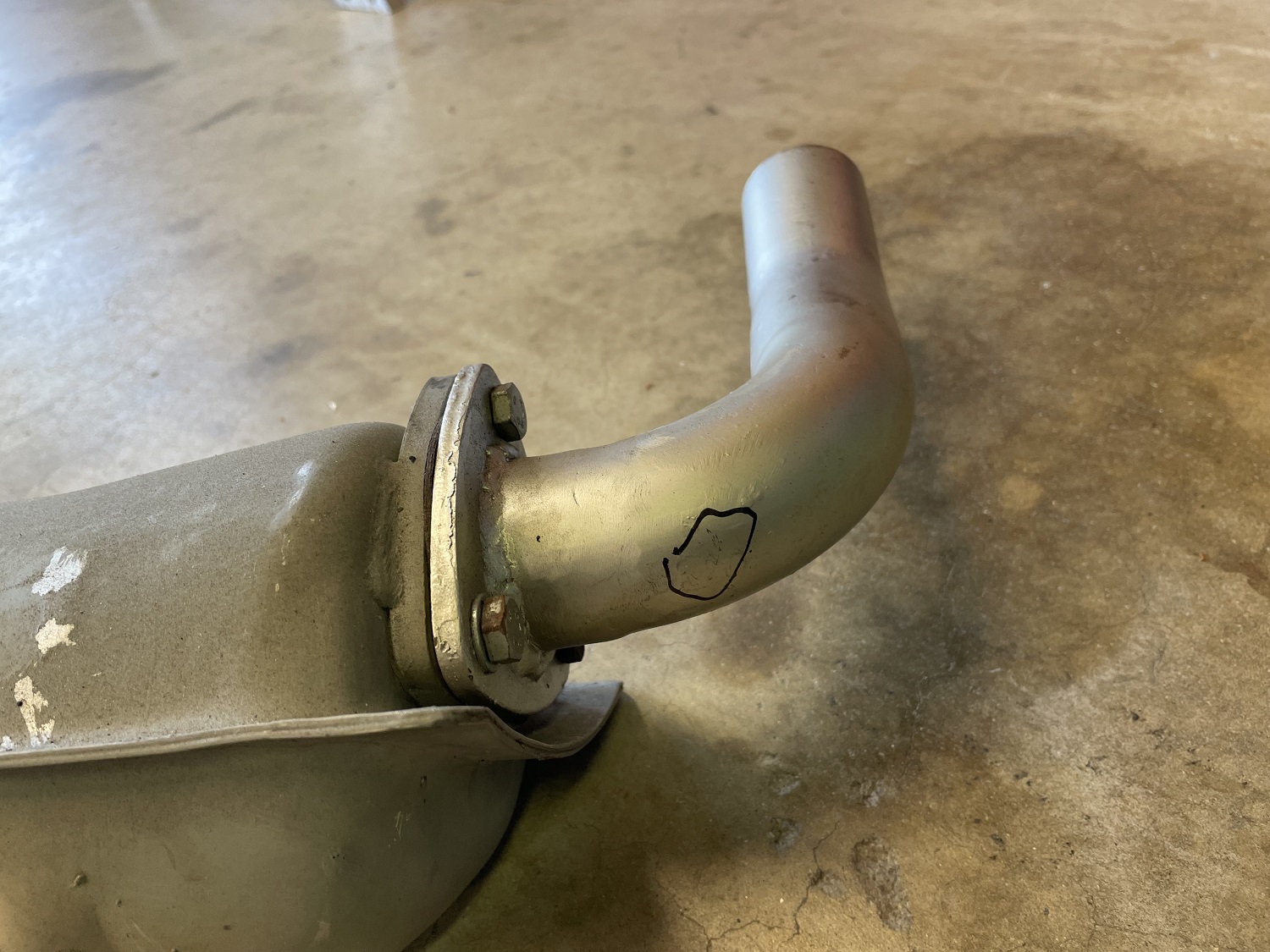

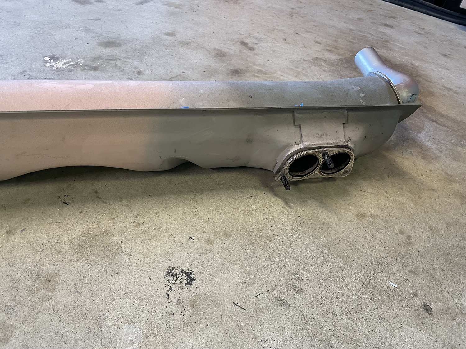

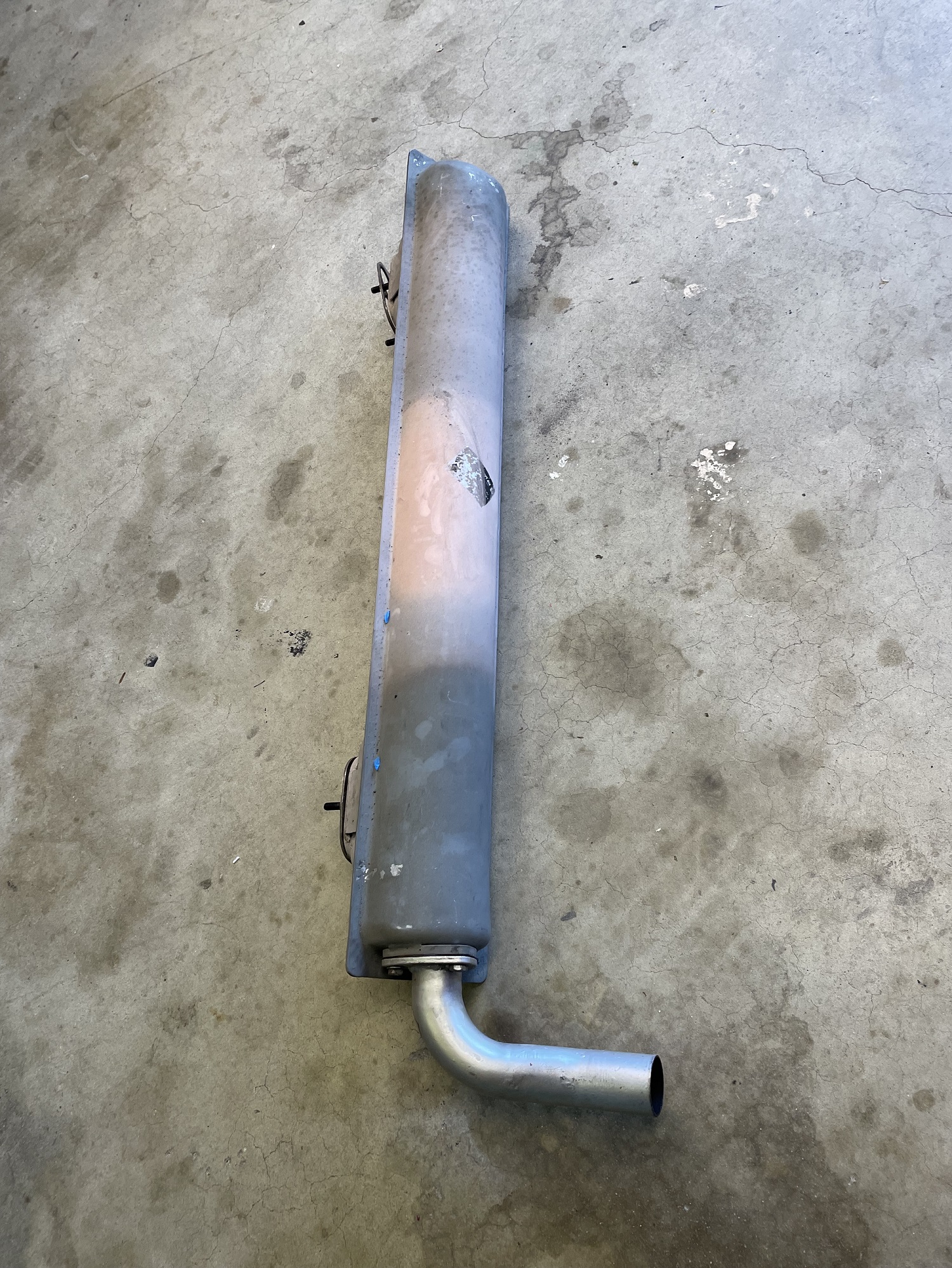

I am going Microsquirt. My current muffler right before I tried cleaning the dust off the part label and it just incinerated is a Dansk 1.8 muffler from what the PO said.
I did have to reweld and rotate tip to exit correctly under the valence.
Maybe it was a bus muffler?
Anyone have any experience on where to place the AF sensor bung, too bad its not on the car to check for clearance/obstruction issues.
I was thinking of welding it on the tail pipe where the black circle I marked off.
I could buy a new exhaust with the bung attached, but this is my attempt at going Microsquirt without spending too much and work with what I have.
Anyone cut one up before and know of a good spot?
Thanks in advance.
Ted

You are going to want it closer to the heat I think. Mine is right at the collector but it is an ansa so it was easy. You don't really have that on that muffler.

I've been running Microsquirt for a couple of years now. I don't have experience with that specific muffler, but if I had to guess the place you propose is as good as any. I'm always hesitant to drill into the "body" of the muffler for fear of upsetting the internals, and you don't have too many options there. I'm sure others can provide more specific guidance.
Yes, clearance is an issue to be concerned about. Take into account not just the sensor but the cable and the fact that you have to get it all lined up to thread it into the bung. That means you either need more space than you may realize or you have to remove the muffler before installing/removing the sensor.
Running Microsquirt in closed-loop on a type IV can be a little tricky, particularly at idle. Idle AFR numbers can be misleading on our motors due to a number of factors. I initially ran closed-loop using a stainless steel, dual-tip muffler sold by a vendor here. It had the O2 sensor bung pre-installed, presumably in the "best" location. It is a great muffler, but for whatever reason I could NOT get usable AFR numbers at idle. Always showed way too lean and had me chasing my tail for months. Above 1500 RPM or so it was fine and closed loop worked great, but idle was useless.
Eventually I switched to another vendor's muffler, with single-tip, and voila', my AFR numbers at idle were useful.
So: make sure you heat exchangers/headers aren't leaking at the heads. Make sure your muffler is not leaking at the heat exchangers. And don't drive yourself crazy chasing a specific idle AFR or closed loop setup at idle if it just won't happen with this muffler.

Within 12" of the header. If installing on a horizontal tube be sure to located between the 10:00 & 2:00 o'clock positions to avoid moisture collecting in the sensor. (IMG:style_emoticons/default/beerchug.gif)

WB O2 sensors are heated and can be placed anywhere in the system.
On a turboed car we put them at least 18" down the exhaust system as the heat can shorten their life.
Any sensor in the exhaust system should be "in the roof" as water is a significant byproduct of an ICE engine.
1 gallon of fuel burned equals approximately 1 gallon of water output. Some sources say more!
The only place that both sides come together is internally in the muffler and at that tip.
The tip looks fine with one exception...
Any negative pulses (shitloads in an exhaust system) will pull clean air UP that tip and it will probably read leaner that it actually is...
Does someone have a cut-away picture of the inside of a log type muffler?
Where the two sides come together internally in the muffler is where I'd want my sensor. Placing the sensor in a primary will only show that cylinders AFR. Placing at tip may yield in-accurate results.
Really serious folks will put one in each primary with individual EGT probes as well.
Car ends up looking like a science experiment...
One work around might be to lengthen the tip. I don't know how long it needs to be but I would think something 24" long would tend to reduce the fresh air pull that can happen.
The short tube effect on the sensor would be more prevalent at low engine speeds IMO.

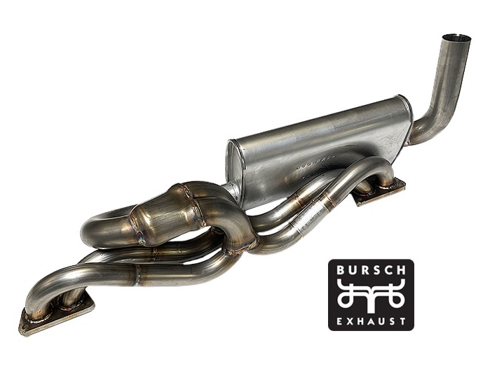

You'll be money ahead replacing that with an different/better muffler like a Bursch.

I've got what I believe is a Bursch copy that extends the primaries into a 4-way flange and has a single tube into a simple muffler. That tube is where I'm putting my sensor.
So, a good answer from me on where to place the O2 sensor bung is after the primaries have come together, before the muffler section, as far away from the heat as possible, and mounted in the roof of the pipe.
If I had 3K to spend on my 914s exhaust I'd just hit up Chris Foley as his systems look perfect to me, opposing cylinders are paired, clean collectors, and his O2 sensor bungs are in the right place. Nice stuff in my book.

Where would the best place to put the bung on that Bursch ??
Could you mark it on the picture (Please??)

I'd put it in the final collector where the two tubes come together pre-muffler or in the section of single tube directly after the merge but before the muffler.
That final collector has a nice flat spot for welding on a bung...
I like that version better than others. It appears to have opposing cylinders merging together first and then a merge from the paired cylinders.
It might have two negative reflections in operation. See Tri-y exhausts for the V8 versions of for explanation.
Two collectors should create two negative scavenging "waves" at different RPMs to assist with cylinder filling.
I like multiple collectors. (IMG:style_emoticons/default/first.gif)

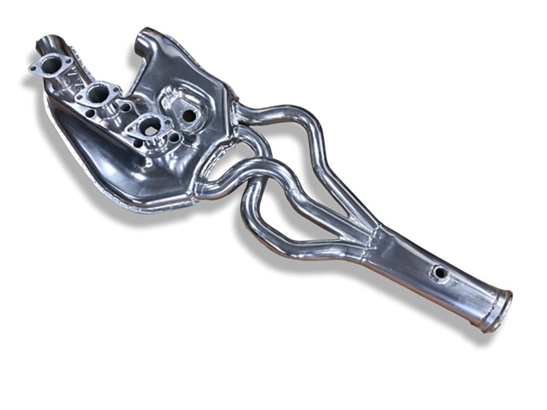

Rick,
This is where PMB Performance put the O2 bung on Factory heat Exchangers on my 6 when we changed to EFI
Just so you could have a look see.
Bob B
technicalninja
post Sep 12 2023, 06:57 AM
Posts: 2,531
Joined: 31-January 23
From: Granbury Texas
Member No.: 27,135
That location is EXCELLENT!
You are going to need two sensors with that system...
Bob, your stuff is always world class!

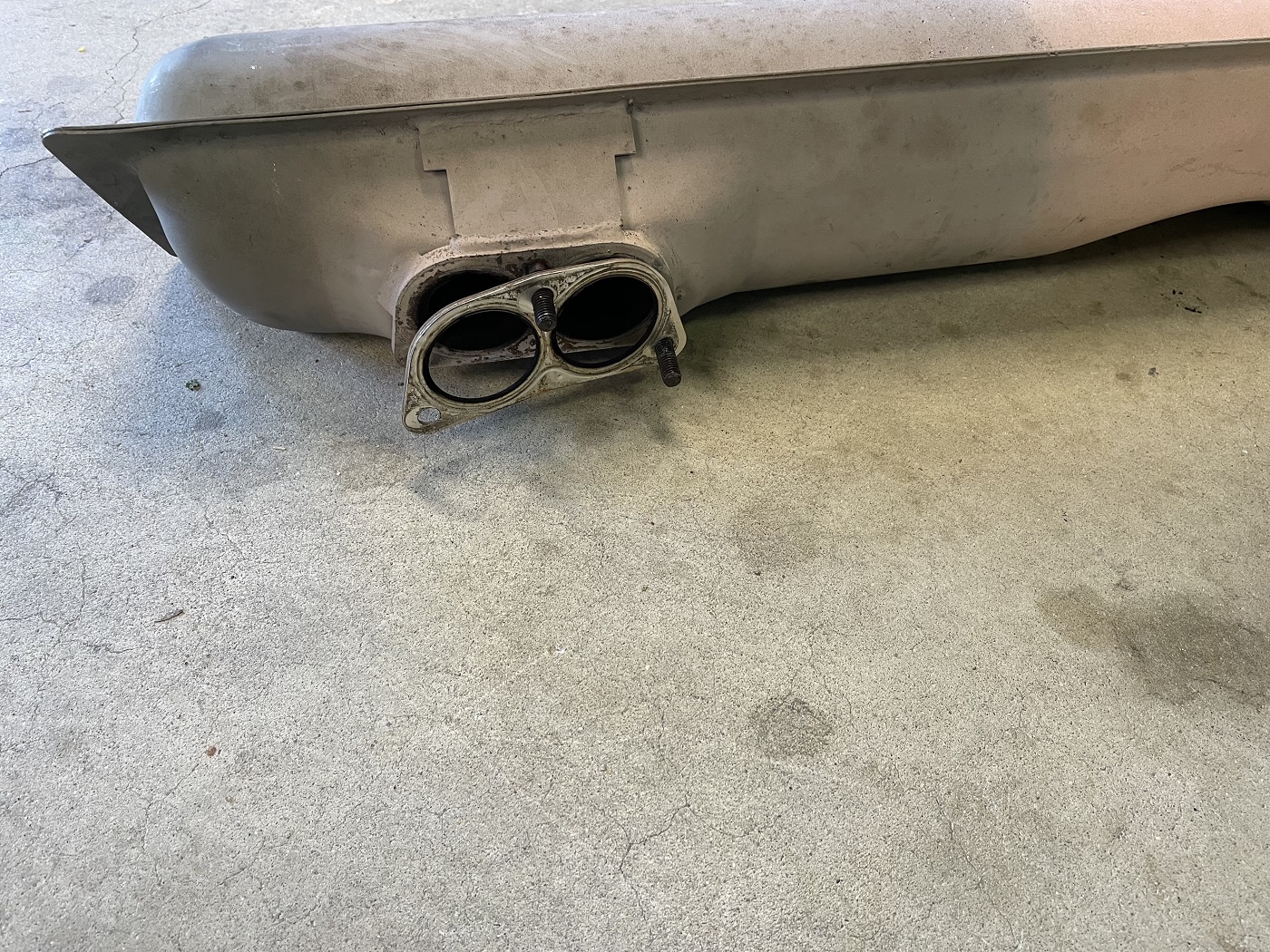

Best location with your current muffler would probably be directly above the passenger side flange but what I would recommend is just pick up a used Bursch and install the bung right after the collector. Use this to setup your tune and then switch back to your stock muffler when done, running in open loop.
The Bursch has enough back pressure after the collector to keep fresh air away from the sensor at idle. You might be ok with your stock muffler but there is also a high chance you will get false lean readings at idle and lower RPM. I have seen this with quite a few mufflers.
