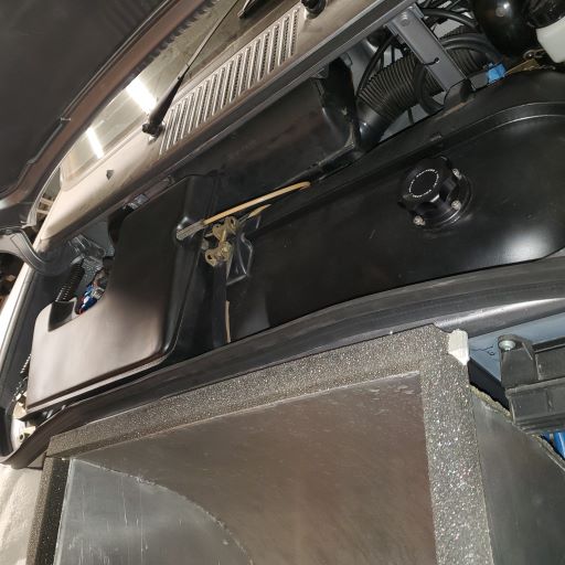

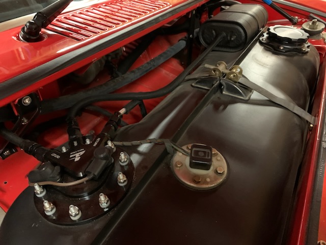

FL000
post Oct 24 2022, 07:47 PM
Posts: 481
Joined: 31-January 12
From: Lancaster, CA
Member No.: 14,076
This is my setup. Evap canister didn’t fit but vent goes to charcoal canister then back to air intake.
Fuel slosh smell is still an issue but only when filled to the brim and on the turns.
Mowog4
post Oct 24 2022, 09:10 PM
Posts: 361
Joined: 2-November 15
From: Mesa AZ
Member No.: 19,325
QUOTE(FL000 @ Oct 24 2022, 06:47 PM) *
That looks great, very clean. I’ll need not to fill to the top.

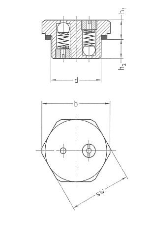

falcor75
post Oct 24 2022, 11:06 PM
Posts: 1,579
Joined: 22-November 12
From: Sweden
Member No.: 15,176
Region Association: Scandinavia
There are two way springloaded vents that only vent when there is an inside/outside pressure difference.
I am using this for my seven replica and I have zero issues with fuel smell in the garage.
Mowog4
post Oct 25 2022, 08:08 AM
Posts: 361
From: Mesa AZ
Member No.: 19,325
QUOTE(falcor75 @ Oct 24 2022, 10:06 PM) *
Interesting, where did you source it?

falcor75
post Oct 26 2022, 12:55 AM
Posts: 1,579
From: Sweden
Member No.: 15,176
QUOTE(Mowog4 @ Oct 25 2022, 04:08 PM) *
I bought it locally here in Sweden in a store that specialises in industrial parts (llike McMaster-Carr) but you could make one yourself from a threaded plug, set screws, springs and ball bearings.
Here is a parts link.
https://www.wiberger.se/produkt/m_tsvv
Love your tank setup as I'm thinking of going intank pump with EFI. Is that a stock tank you modified to accept the intank pump?
