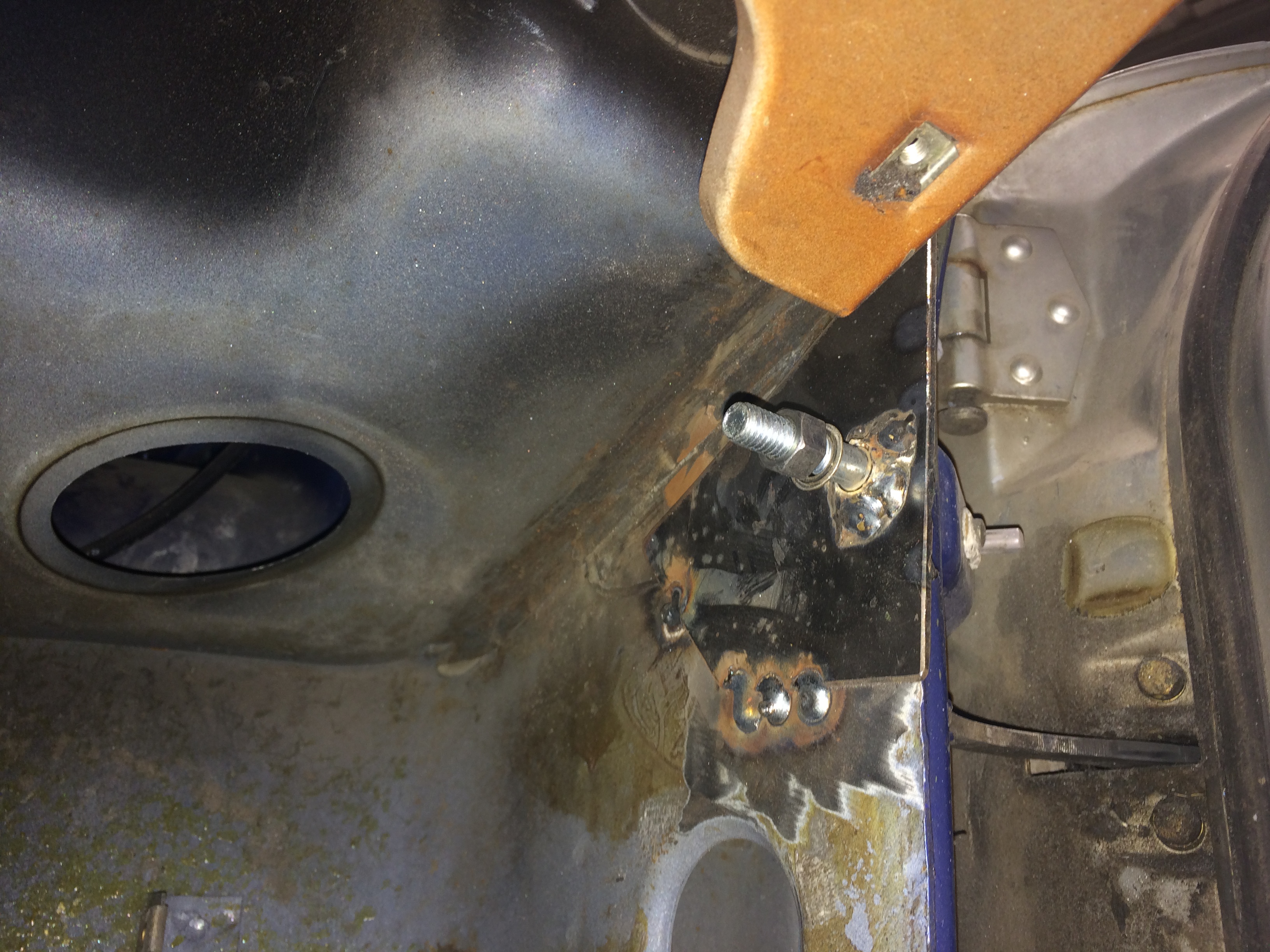

Here's my super high-tech design. No doubt yours will be a bit more professional but this worked just fine.

QUOTE(tygaboy @ Oct 17 2016, 03:57 PM) *
Our welded-in-place nut plate won't need to be removed after the work is done. (IMG:style_emoticons/default/piratenanner.gif)
