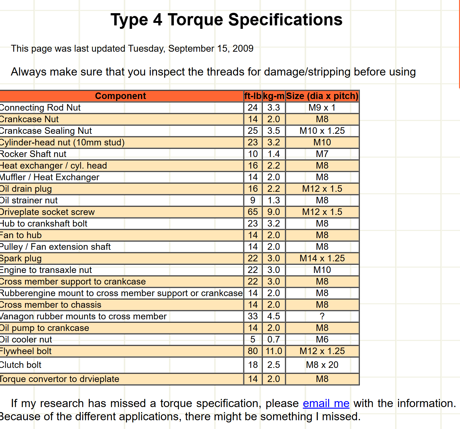

Uraquan
post Jan 30 2026, 12:23 PM
Posts: 4
Joined: 22-March 19
From: Atlanta, GA
Member No.: 22,981
QUOTE(bob91403 @ Sep 25 2004, 05:31 PM) *
Before you put them back on go to www.casperlabs.com/casperlabsinc/id1.html They offer an exhaust stud kit that is well worth a look. Their page takes forever to load. Be patient, it's worth it.
Looks like http://www.tunacan.net/t4/reference/torque.htm has expired. I've attached a screen shot from the wayback machine for anybody else that finds this thread
JeffBowlsby
post Jan 30 2026, 01:28 PM
Posts: 9,168
From: San Ramon CA
Member No.: 104
My engine builder says 14 ft-lbs heat exch to head is sufficient. Used this for years with no issues. Def not a nut to overtighten.
